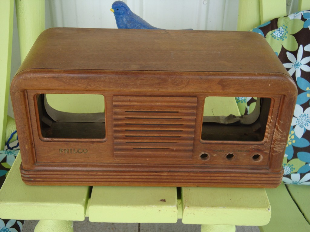

I had restored the cabinet of this radio back in 2013.
Before:

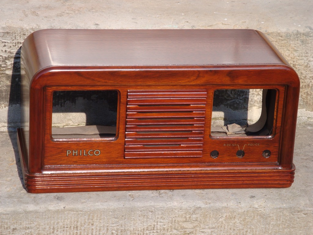

After:
[Image: http://www.philcoradio.com/images/phorum..._00001.jpg]

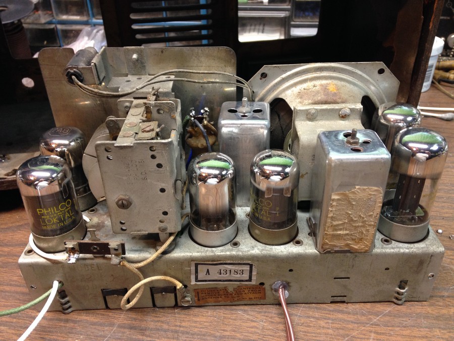

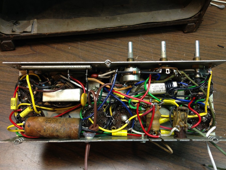

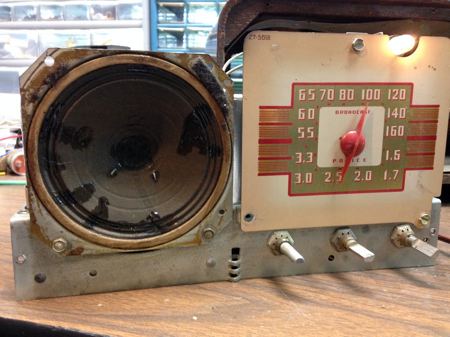

So on Sunday, I began working on the chassis.
Two and a half days later, the chassis was complete. A new world record for me, I think. That's replacing all of the old rubber-covered wiring as well as replacing all paper and electrolytic caps and all of the carbon resistors. Plus two tubes had to be replaced.

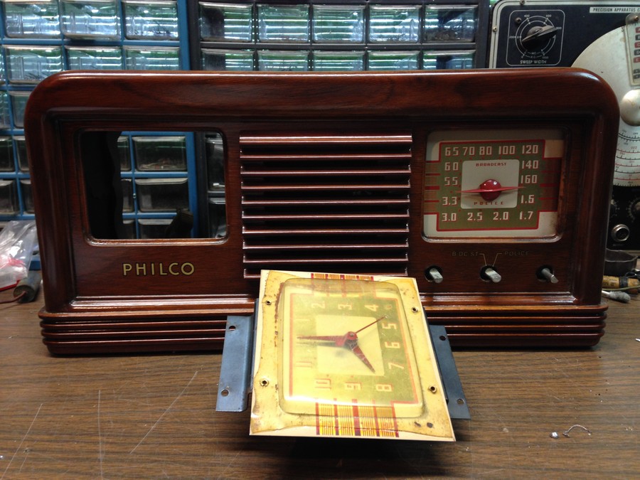

Unfortunately, the original clock is shot. The wires were clipped off at the motor, and the outer housing is missing as is the original two-pin connector coming from the original motor.
I have no choice but to replace the motor with a new one. I found an electric movement at Klockit, and decided to go with it. I have the original two-pin socket which connects inside the radio to supply AC power to the clock, and I've found a matching two-pin plug to take care of the missing plug, so I can at least hookup the new motor as the original was hooked up.

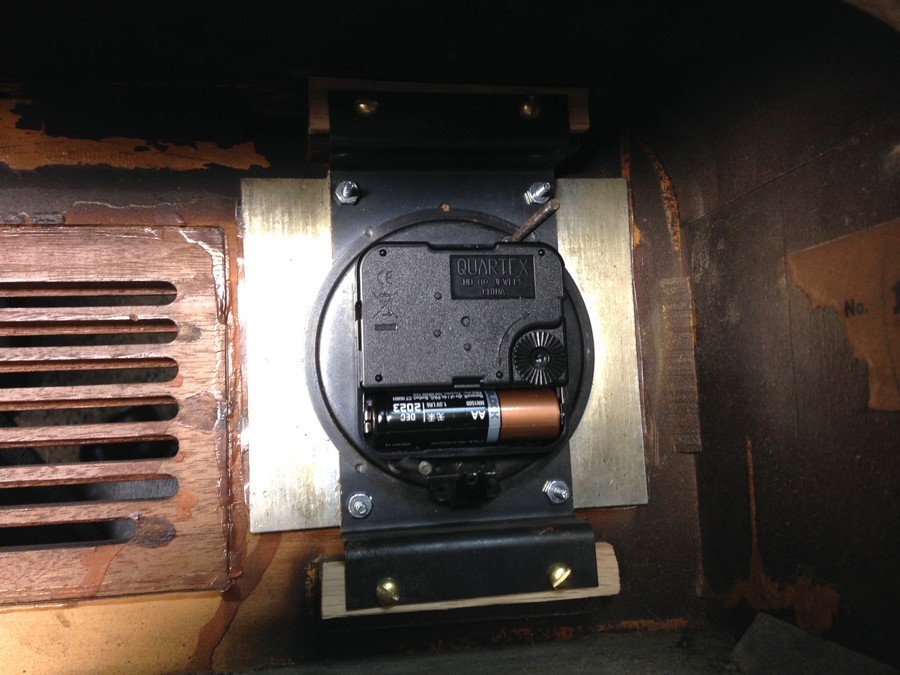

I hooked up the wires which supply 120 volts AC to the clock into the radio. To the other end of these wires I attached the original two-pin socket. As the plug did not come with this radio, I used one from my 41-KR as I plan to convert it to a battery clock movement with sweep second hand.
I put clock hands on the electric motor and tried it out. All seemed well; the clock worked.
So I proceeded to cut the cord and attach the two-pin plug from the 41-KR clock motor to its cord, and attached the motor to the backing plate after removing what was left of the original clock movement. I did this carefully so that it can be converted back to original if someone wants to later on.
Well, Murphy's Law being what it is...naturally, after modifying the thing so I could no longer return it...
I put it all into the 42-22 cabinet. Oh, the second hand ran fine... but the hour and minute hands would no longer move!
So this morning, I disassembled it all.

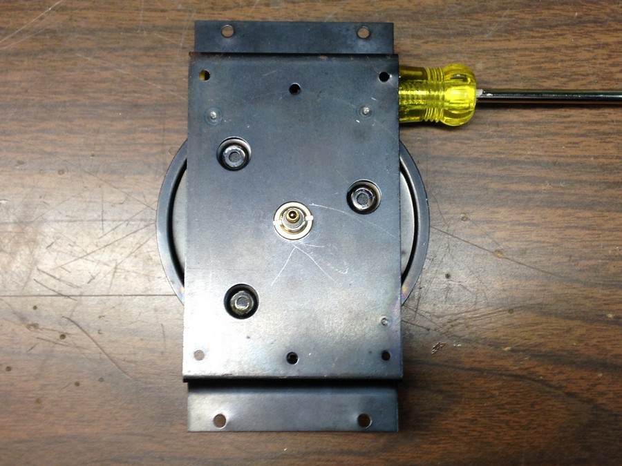

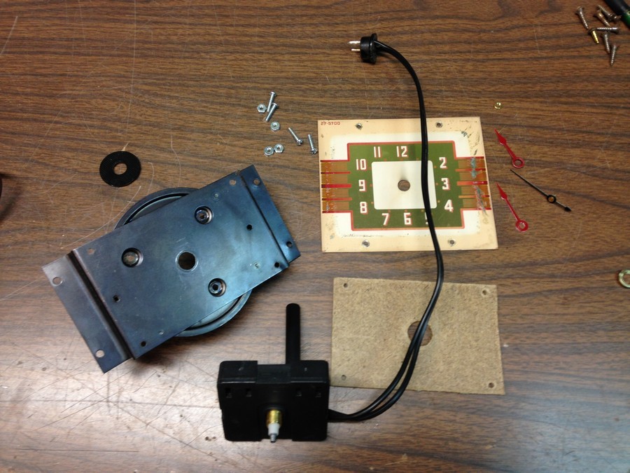

[Image: http://www.philcoradio.com/images/phorum...CL_005.jpg]
Notice how I modified things so the new clock movement could be used. I cut a piece of 1/8" masonite to go behind the clock face to act as a spacer. I also cut two strips of 1/4" wood to space the unit further back from the front of the cabinet. I did all this to ensure that the clock shaft would clear the dial cover. I fastened the dial cover to the back of the cabinet, instead of to the clock face as it was originally, for this reason.
I had a choice of converting it to a battery movement with a sweep second hand (and I luckily had another one of those battery movements), or just forgetting about it.
I chose the former.

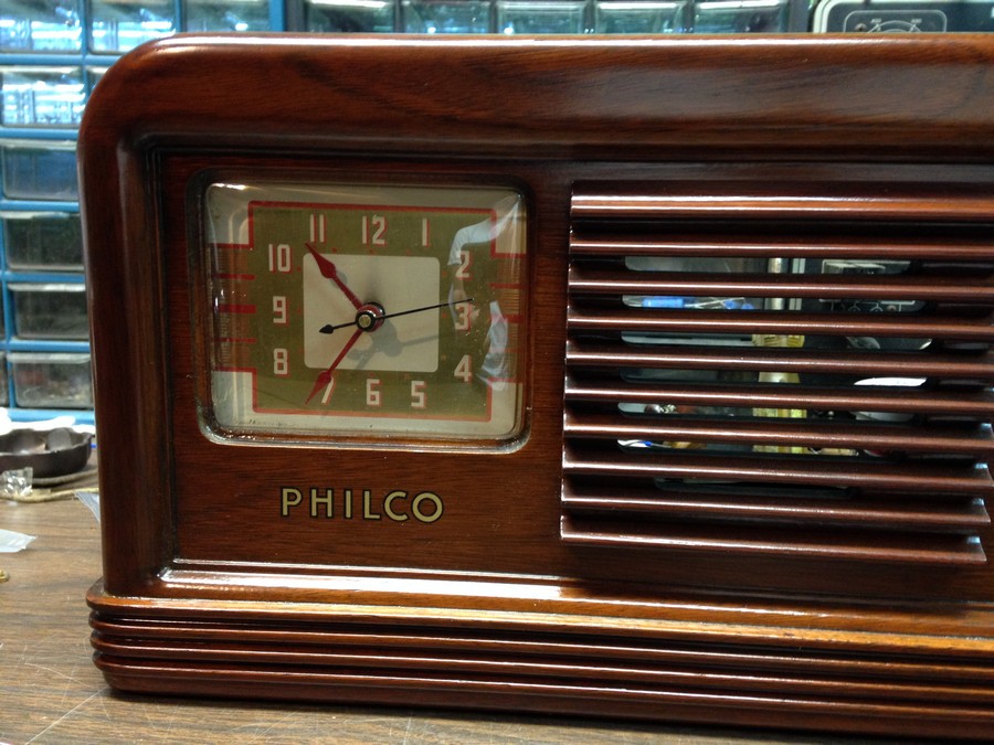

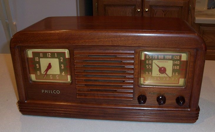

After reattaching the twice-modified unit to the cabinet, here's how it looks:
[Image: http://www.philcoradio.com/images/phorum...CL_008.jpg]
Works fine...and with the sweep second hand, it looks like an electric clock.
I decided not to modify the original clock hands - again, in case someone wants to convert this back to an original electric motor later on.

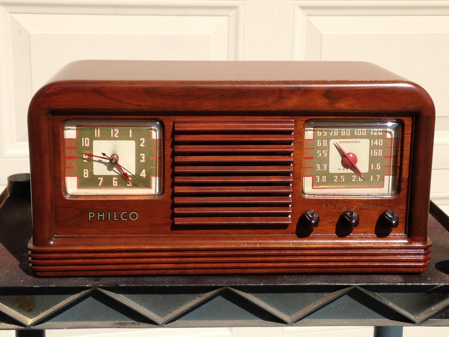

All done...
[Image: http://www.philcoradio.com/images/phorum...CL_009.jpg]
[Image: http://www.philcoradio.com/images/phorum...CL_012.jpg]

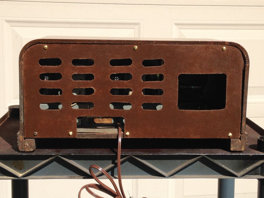

This radio had no back when I bought it, so I made one from 1/8" Masonite.
As for the clock...with a battery movement, it can be displayed and used as a clock without being plugged in. And there are advantages to that, I think.
I feel that this is one of my favorite restorations.  Overall, it turned out really well. Especially considering the condition it was in when I purchased it. The scratches on the right side of the radio dial are almost invisible now.
