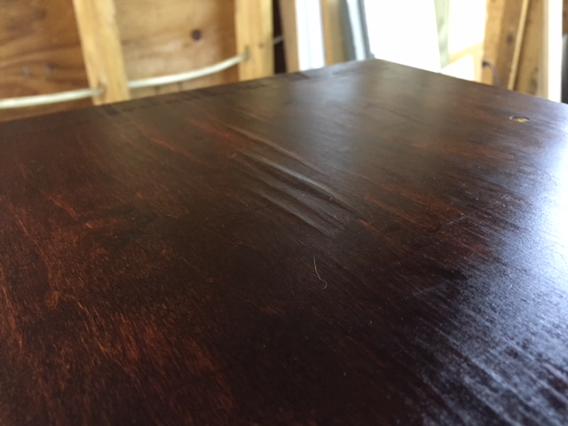

The veneer on thetop of my 16B shouldered tombstone has some small wrinkles:
Assuming I'm going to strip and refinish the cabinet what is the best way to flatten the veneer? Sand? Plane? Other?

Try this, before stripping, cut the wrinkle open with razor blade length wise down the center then carefully lift one side open enough to spray some contact adhesive in there and let it get real tacky before you press it down, then repeat for other side of wrinkle. You can mask off each side of cut mark with tape so you don't get glue all over . Remove the tape.Use a hard roller if you have one and roll it . If you use stripper don't get it in the cut marks. Then you can sand it smooth and the cut mark should not be visible . It works ok but not all the time. I've hade to replace the veneer more often than not on cases like that.  What's that hole doing there if that's the top? If that were my radio I would replace just the top section of veneer, stopping just before the curves on each side. Being stained with extra dark walnut you wont see the difference in grain .I wont be that difficult to remove that veneer because its all dried out and is already lifting, you will have much better results buy replacing and should take less time that's if you done it before and have the tools.

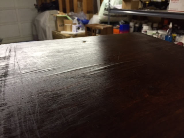

RE: the hole - it looks like somebody decided the flat top was the perfect surface to drill something else on. :/
I think you've convinced me about replacing the veneer. I haven't done much veneer work but it would be good to learn especially on a nice flat piece like this.

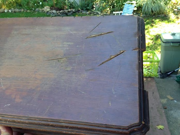

Replace it? I see no reason for that. The pictures show some minor bubbling. The slit method can be good but if you have not done it, it can be tricky. The injection method is better but you will need a drain slit either way, just not as big.
I had that on my 90 arch and I fixed it with the inject method. Iron method is also good when using titebond 2 but it should be applied to both surfaces, let dry and then iron. You cant do that here though.
The drill hole is repairable but if you want to veneer the top then Get rid of the veneer, fill, sand, Use the titebond method and done. Just remember, just enough glue to tack the surfaces. If you add too much glue you will get even worse ripples.
