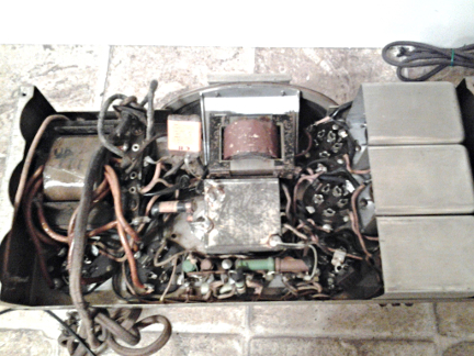

[attachment=7466]Hello, all.
Just picked up this American Bosch 5AC (I think) and am getting ready to recap it and replace the resistors. The schematic calls for twelve caps but I only see six under the chassis. I know that three are the filter caps (C19, C20, and C21), one is a mica, one is buried under the terminal strip, and one is a flat square labeled G.H. Longlife Condensor .006mfd. I'm having a heck of a time trying to see where the other six are.
Here are links to the schematics as well as some photos.
https://app.box.com/s/l832e6urmwid8ponc5co
http://www.nostalgiaair.org/PagesByModel...029566.pdf
Dave

dseverson some times they are well hidden! Have you explored the silver metal box shown on your third picture about dead center next to what I'm guessing is the output transformer? Many model radios stuffed low value caps in such cans.

I was wondering about that box right in the center. I'll take a look.

Should be easy to find. Note the parts list tell where the caps are connected. My bet is on the oval can next to the power xformer.
Note the power supply is drawn upsidedown. Bottom rail is B+. Top rail w/R-12 is B-

Dave, Terry is much smarter than me and indeed that oval can probably holds caps. My guess is the e-caps but there seems to be a label on it that might give you a hint. Unusual package size but who knows? Not me! Wire tracing to the schematic should help.

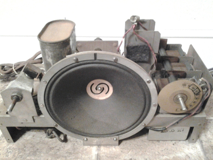

I am pretty sure that oval can does hold three caps - two 4mfd filter and a .08 field cap. The label on it is just a bunch of patent numbers and manufacturer info. It's completely filled with tar so it's staying as is. Just going to clip the wires and add in new caps under the chassis.

I know what you mean, Jerry. It's just a lot of tar. Might be able to pave part of my garage floor with all that tar. The metal box under the chassis is full of tar, too, and it appears that is where the rest of the caps are located. It's got ten wires coming out of it, so it holds five caps. I am pretty sure I can figure out which caps they are following the schematic. But now I am leaning toward attacking both the cylinder and this box with a heat gun to keep the chassis looking clean.

Correction. Looks like it holds nine caps with a common ground. Does that look right to you guys? I can't see where they are grounded, though.

Check the parts list page, it's pretty self explanatory what goes inside each block condenser can, it looks like it even gives the colour code for the leads. The filter condenser can has two capacitors inside according to the list, (in fact they may be large paper ones given the age of the set) since it has three leads, one goes to the transformer center tap, one goes to the filament connection on the rectifier, and the third goes to the B+ connection on the terminal strip. The bypass condenser assembly, no doubt the metal box under the chassis, dead center, has four capacitors, a 1 uf, a .01 uf, a .05 uf, and a .25 uf, so there are four wires, the ground end of each is likely soldered to the tin box which is screwed or riveted to the chassis, possibly with a blob of solder as well. One nice thing about this set is that if you want to break down and restuff the filter condenser can, the filter caps can easily be replaced with large poly film capacitors since they are only 4 uf each.

Just took the tar out of the bypass condenser. It definitely has 8 caps. Hopefully, I read the schematics correctly and have all the wires labeled for the correct caps. The wires have lost their colors. Next comes the filter condensor.
