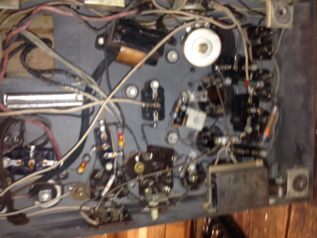

Here's a pic he sent me of the underside.  Can anybody tell me if it's the model above s/n 22,000?

I can tell you that with those Sprague caps, rather than Mershon, it is a later production chassis. But that is all.

Crist, it is an early version. You can tell at a glance by looking at the back of the chassis. The early version has three trimmers on the back, the late version has four.

Anybody know what that bright silver pot looking thing is? I don't see it anywhere on the NA docs.

Whatever that potentiometer is, it isn't original. But you can correct that later.

Ron, Thanks for your input.  I suspect the pot has something to do with the volume pot being bad and somebody kluged it in.
