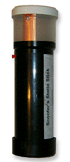

    I have 3 record platters from 1950's Philcos that I need to reflock.  They were flocked originally by applying an electro static charge to the record platter - which produces a nice even and fluffy surface.  I can't find anyone who does this anymore online.   There is a company that makes an electrostatic flocking applicator device - costs about $120.00.  I wonder if any of you have tried this?  Company claims the high voltage charge follows the flocking fibers onto the surface you are flocking - wondering if this works well and will reproduce the nice even, soft surface found on these record platters from the 1950's.
https://www.craftflocking.com/shopping/p...d=258&=SID
[attachment=7621]

Thanks Jim - I did contact West Tech - they no longer do it. I think I will just try it with your method - but maybe I'll practice on some scrap metal first. Thanks for your detailed explanation on flocking.
