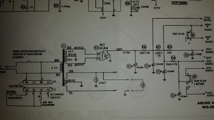

Here's a pic. Hopefully, it's clear. This particular can is in line with the 6CA4 rectifier.
It's C1-B by the way.
It's 40, from what I read. But size won't matter in that location, except to improve the filtering a bit.
It's a 40uf and 60uf multi-section can. I'll replace that 60 with a 100uf to keep things looking neat.

Keep in mind that the 40uf is on one side of the resistor R36 and 60uf on the other. if you use one 100uf cap I don't see how you will be able to seperate it to each side.
If C1B, yes you could use a larger value.
But something doesn't jibe in you expkanation about values.
Can you in simple language say: Ok, this C1A is this value, C1B is this, I am changing this cap for this value etc.
Sch does not show 60uF so you saying BTW it is a dual 40-60 cap does not really help explaining anything.
Forgive me for not simply stating it. The parts list for the C1 multi-section capacitor calls for a 40uf cap for C1A and a 60uf cap for C1B. I did not notice previously that the schematic shows C1B as 40uf. For anyone who did not understand my question, simply stated, is it possible to replace C1B 60uf with a 100uf? Before I move forward, however, I will visually check C1 multi-section capacitor to determine the correct value of C1B.
Yes it is possible. In this particular case (within reason) the more the better.
