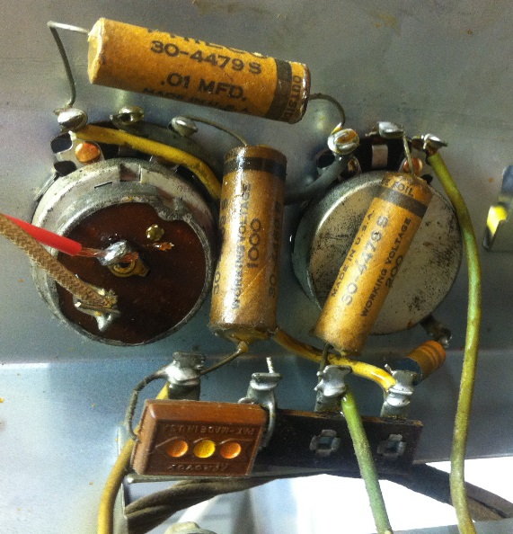

I didn't have an issue with my tone control on my 40-180 post recap. I have a pretty clear shot of it pre-recap I can post here or PM you with later tonight at home if that will help you.
Yea, that would be great. You can just put the picture on this post since I don't know how to PM. Thanks for the help!
(07-13-2015, 09:58 PM)sdradioman Wrote:  Yea, that would be great. You can just put the picture on this post since I don't know how to PM. Thanks for the help!
PM is Private Message.  It's like a post here on the forum, but only you and I can see it.  So not everyone has to see an obnoxiously large picture if I were to post the fully uncropped and unresized picture.  But here is a slightly cropped and slightly shrunken picture.
Yep, that's how it was when I started and that was how I recapped it but the tone doesn't change. I think I may have a bad pot then. I have a spare that I will swop out and see it that changes anything. Thanks for the picture!
So it ended up being the tone control pot. I disassembled it and inspected. I don't know what happened but it must have happened when I was cleaning it. The entire carbon pad was for lack of a better word, desintigrated. I nabbed one out of a 40-185 that I had and it works perfectly!
