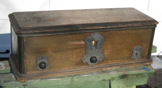

The top of the cabinet is in the worst shape (as usual) so I hope to get the white stains off in the clean up.  The front isn’t too bad.
[Image: https://www.dropbox.com/s/4wk0zi071j5opm....jpg?raw=1]
[Image: https://www.dropbox.com/s/r4oe29a9ibtdse....jpg?raw=1]

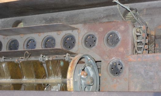

Has all shoulder tubes except for one 27 globe.
[Image: https://www.dropbox.com/s/ozlu57qdf2uk99....jpg?raw=1]

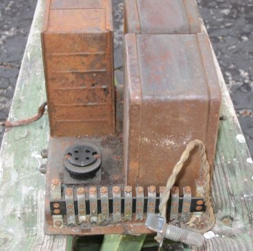

I finally figured out how to get the beast out of the cabinet by separating the two chassis sections.
[Image: https://www.dropbox.com/s/g6ddylp553idib....jpg?raw=1]

I finally finished the Radiola 60 and 103 speaker and delivered it back to the museum today.  The cabinet came out nicely.
[Image: https://www.dropbox.com/s/cgbf6d3hwxxq87....jpg?raw=1]

The chassis restoration went pretty smoothly, the most difficult was to get the filter box apart.  There is a fiber board cover over the lugs that came off easily but the frame that the connecting lugs are on took a little heat gun action to loosen it followed by clipping the cap connections to it would all pull away.  You should be sure to unsolder the choke leads that are also in this can because you need to retain that.  Here are some photos of the various steps of getting the old caps out and putting the new ones in.  I also had to make a wood frame to hold things in place, although you could also fill the can with wax to do the same thing.
[Image: https://www.dropbox.com/s/xunqcz79ldx6we....jpg?raw=1][Image: https://www.dropbox.com/s/rijidhsso8oynq....jpg?raw=1][Image: https://www.dropbox.com/s/fo47f6jf41s7e7....jpg?raw=1]
[Image: https://www.dropbox.com/s/vxfijrfoh5ntzc....jpg?raw=1][Image: https://www.dropbox.com/s/hlwsv31wpfjni8....jpg?raw=1][Image: https://www.dropbox.com/s/awhyjrttipej3o....jpg?raw=1]

The filter can itself has sides that slide together and if you get one side off the rest will come apart easily.  I set the can on the side of the bench and used a hammer to tap one of the sides to slide it off.  It bent the side a little but was easily tapped back in place.
