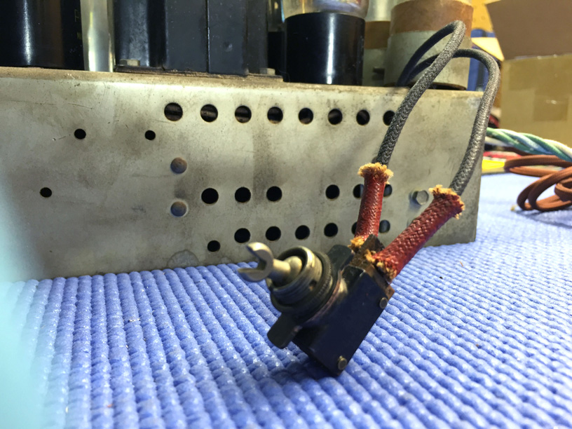

My Philco 16B 'shouldered' tombstone has a rather unique looking switch for the automatic volume control (switch on the side for enabling or disabling inter-station silencing):
Could this be original (it is different from the other 16Bs I have seen) or is it an antique repair job?
Repair job. The original would not have had a slot cut in it like that.
Oh, and the switch in your 16B-125 is for bass compensation, not AVC.

Looks like a switch from a National Co communications set. The notch is there so it can be flipped by rotating shaft. Used for the off/on, send/receive, standby, and bfo.

Interesting - OK. I wonder why that switch needed replacing - seems like something that wouldn't get used often.
Ron - RE: the purpose of the switch. Mine is actually one of the 16B tombstones with a Code 121 chassis in it. AFAICT it was this way from the factory. It has a fully finished wood plug to reduce the size of the tuning shaft opening ( earlier thread) - and re-drilled chassis bolts holes that look to me like they were professionally done - or at least done before the cabinet was finished. The sticker in the cabinet still says Code 125.
slingn Wrote:...Mine is actually one of the 16B tombstones with a Code 121 chassis in it. AFAICT it was this way from the factory. It has a fully finished wood plug to reduce the size of the tuning shaft opening (earlier thread) - and re-drilled chassis bolts holes that look to me like they were professionally done...
By the time Philco introduced the shouldered 16B cabinet (around January 1935), the old 5-band chassis had been out of production for three months or so, and they made over 18,000 of the "peaked" cabinets. I would say 95 to 99% of those had the newer 4-band chassis. So once the shouldered cabinet went into production, Philco would have only had 4-band chassis in production.
The point? Any competent, skilled woodworker could have made the plug for that larger hole for the tuning shaft, as well as redrilled mounting holes in the bottom. I do not believe this was done at the factory, but by someone after the fact who had a 16-121 chassis and a 16-125 shouldered cabinet, and was skilled enough to perform a shotgun wedding of the two.
Finally, if it had been done at the factory (and it was not, in my opinion), they would have tried harder to match the surrounding veneer. An at-home "weekend warrior"? Not as likely to try to make the plug match the veneer.
