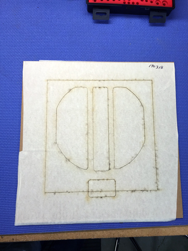

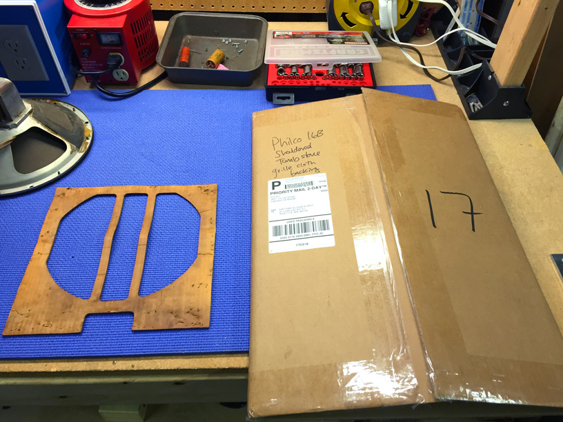

Here is what arrived in the mail:
They send you the full piece of material you used - each side covered with white stick-on paper (looks like to protect the material while cutting).
Peel off the paper and...voila!
Cutting edge technology used to restore a 1935 radio.  Icon_lol

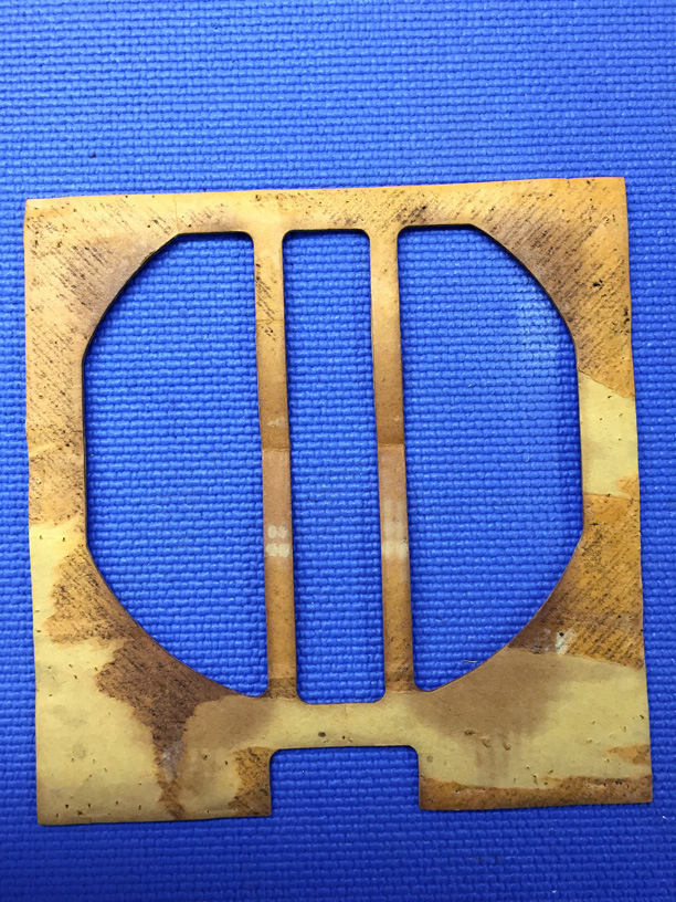

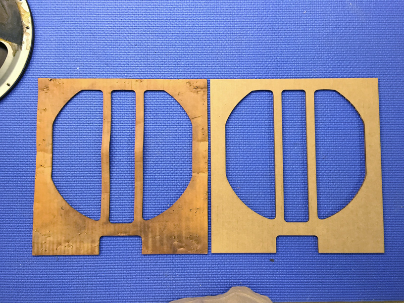

This time a new backer for my 16B 'Peak Top' Tombstone (the later version). The old backer was disintegrating so I decided to scan it in and go the laser cutter route again.
Rather than cardboard, this time I selected hardboard since the thickness of 0.118" is a close match for the original.
The design is available at Ponoko. I also attached the EPS file here in case you want to modify it.
It cost $30 total ($6 material, $14.80 laser cutting, $9.50 shipping). Yeah, not exactly cheap. But maybe it makes up for it in cool factor? Icon_smile Anyway, here was what Ponoko sent back:
