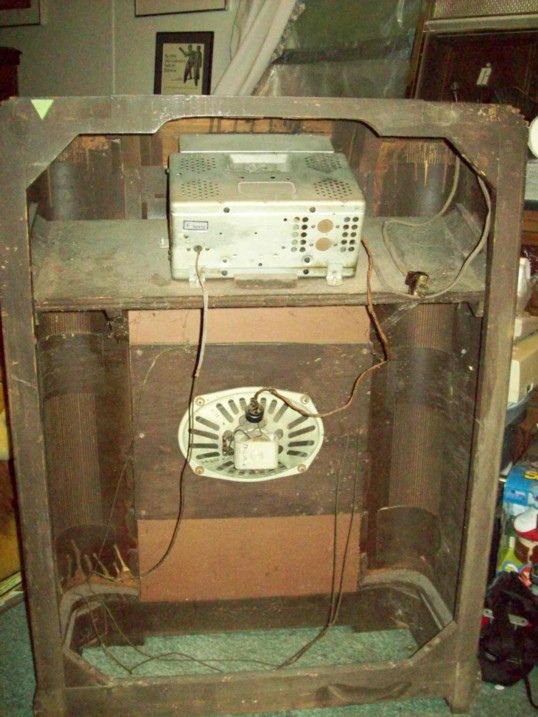

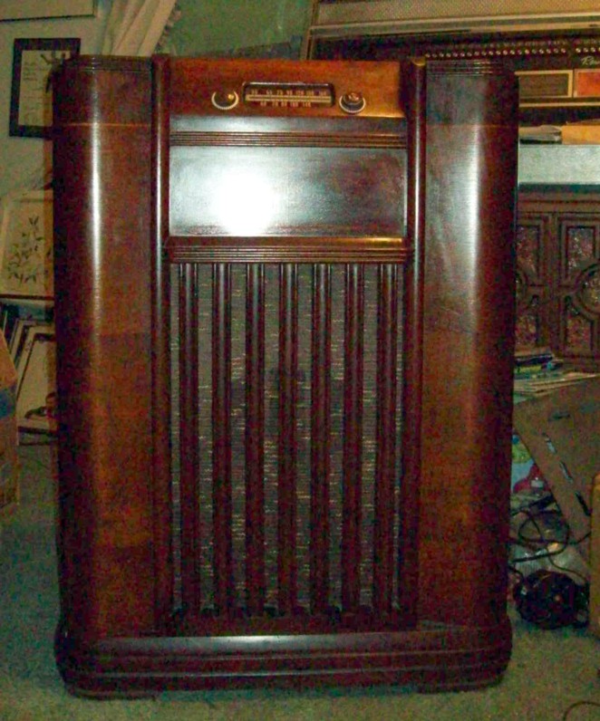

After a couple weeks of no responses to my emails and phone calls, I decided to stop in personally at the shop in Barberton to see if the Philco A-361 console was still there. Turns out the shop had changed hands and the Philco was still there and priced $50 lower than it had been in the ad! So, I snagged a nice Philco A-361 console that seems to check out on transformer and even picks up a few stations when brought up on reduced power. Shows plenty of good signs. Cabinet does have a few blemishes, including a crack above the dial that seems caused by poor wood. Speaker looks good except one spot I repaired at the edge of the cone. Actually looked like the paper was simply too thin and wore away over the years. I think with a recap, and a good realignment, this will be a nice set from a unique time in radio history. Chuck: Do you have any paper work on this model I can order?
P.S. The one picture came out dark and grainy, I don't know why. Radio looks better than that!

Neat "car radio in a console cabinet" set. I've often wondered if the knobs on these were later used on the 1201's and hippo models after the war? I've never seen a real clear picture of them, but they do appear to be similar.

While the knobs look a bit like the ones on the Hippo, they are different animals. There is a plastic knob mounted in front of a metal ring. The ring behind the volume knob is actually a tone control while the one behind the tuning knob is just decoration. I've noticed that the tuning knob has shrunk and warped, causing it to be hard to get off the shaft. Also, the shaft rusted some where it made contact with the plastic while the volume knob and shaft are just fine. Not sure what plastic they used, but it is actually transluscent as light will shine through it!

Be careful when you get around to cleaning the dial lens. The numbering and the lines on the back side will come off very easily. I learned the hard way.

Thanks for the advice. The dial lens looks decent, so I will just let it be.
