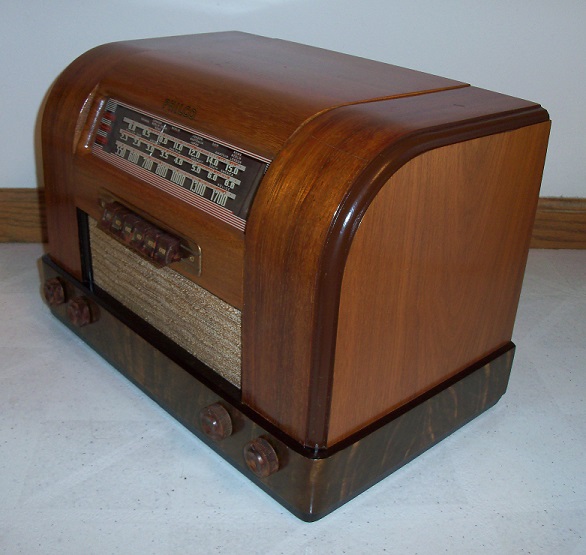

Very, Very nice! Did you have to do much on the original finish? It came out looking great! Nice job.

Thanks. Just gave it the "Goop" treatment and the cabinet came to life again. I was really amazed!

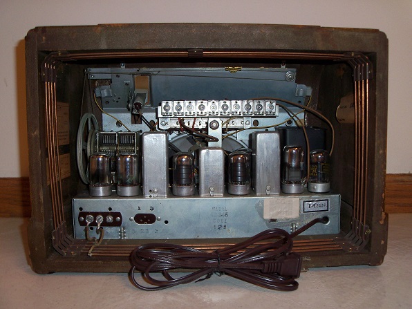

I'm not sure you have the same model, Todd. This set uses 7 tubes:
two XXL's, two 7B7's, 7C6, 7B5, 7Y4

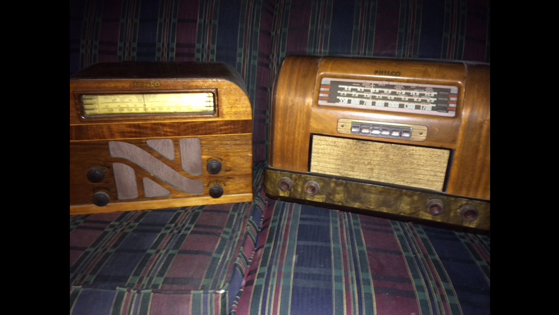

Oddly enough Greg that is the set I have upstairs this weekend, mine lost the photo finish though so I am not as original. I love that internal antenna, and it is a good receiver. Hope to chill later today, some music, maybe a frosty, put on the fan and hope I get no Thunderstorms.

Jayce, You should make an offer. I don't think you'd be disappointed. It's a fairly straight forward set, and doesn't seem to have too much of the crumbling wire syndrome. At least not in my set. I only had to replace one or two wires. Caps are relatively easy to replace, save for two .05's buried against the side of the chassis under a coil. You'll have to install new rubber bushings for the push button assembly, which will most likely be loose and flopping around. The off/on push-button can be a little wonky and either stick on or not stay on. Contact cleaner will dry it out so I had to follow up with a squirt of WD-40.
Paul, I have the original XXL's in mine. They tested good and perform as they should.
