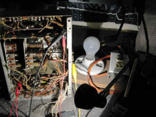

Before jumping in and replacing caps / resistors I want to evaluate it's current condition.
There are NO previous repairs. It's totally unmolested.
I will test the tubes shortly, once the sw was jumped the chassis drew current not excessive.

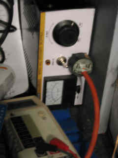

And yes, of course it was on an isolated B&K variac through a lamp for safety.
That's where I stopped until I can get at my hickok tester to check the tubes.

I have a "light" current limiting jig and I also connect any of this vintage stuff through a B&K isolation supply.
