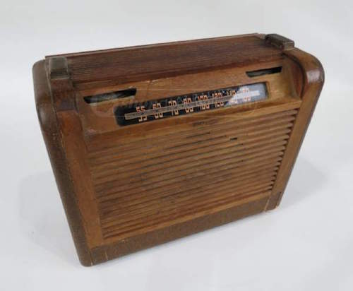

I just won a Philco for $5. What do we know about it besides its being a portable? Sources for the leather handle? Selenium rectifier, I would imagine...I can replace it with a resistor/diode combo? I hope the roll top works. I'm pretty excited. It was a local auction, so it really is just $5.

Thanks for the advice. I haven't opened it up, yet except to look inside the cabinet. I closed it back up for now, and will start the massive clean up I'll need to do soon. For the record, you mean R13 and R11? Is R11 two 900 ohm resistors?
