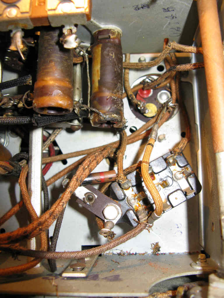

There are 2 "flexible"  resistors, one is definitely open, according to the schematic I have, I think it's suppose to be 400ohms and feeds the cathode of the output.

What should be used to at least replace that one flexible resistor (wattage) I know is bad.
I removed the covering on the flexible resistor to verify what it was and that it is open.
See attached picture and drawing on schematic showing  that area
