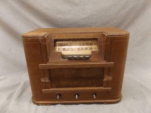

  I take it that this Silvertone has a Bakelite or a Plascon cabinet? If this is the case then it need not be too expensive to repair, plastic auto body filler or fiberglass resins are fairly economical and will do a decent repair job if you do not mind a painted cabinet afterward. You could probably go into making molds and using epoxy and dyes to replicate the original material, but it probably isn't worth it unless it's a rare or valuable set. Sometimes it the set is common enough you can find an empty cabinet as a replacement. If it's a wooden cabinet it can be even easier, if you know what you are doing, repair on those can be made almost invisible.
It's wooden. I manufactured a piece to go in the gap. It's about 4" long and maybe 1/2" wide. The hard part was figuring out how to router a curve for the corners without a router. The ribbed crossmember has me stumped. I'll have to hit the craft stores and look for something close, or just leave it off, but I'm taking this thread into cabinet restoration, now, so I'd better let it go. Here is the cabinet the way I got it. I plan on putting a darker tone around the edge of the top and on the bottom, so I think I'll match the darker tone around the dial and push buttons. Finding knobs and push buttons is going to be difficult.
