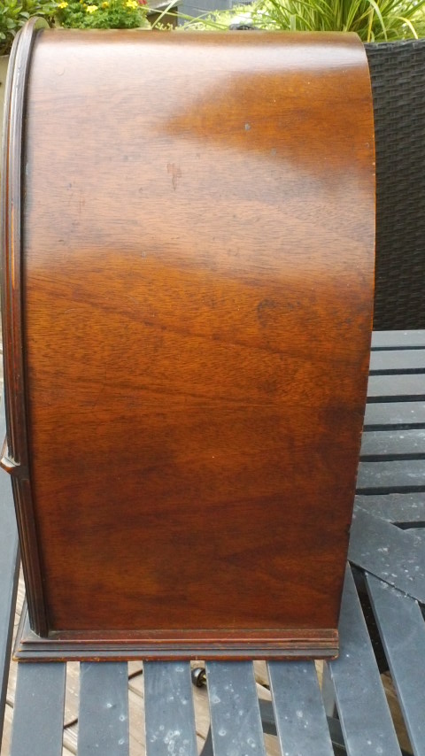

What a beautiful radio!
M R Radios   C M Tubes
Thank You...I spent most of the day cleaning years of tar and nicotine off the cabinet and that is what was underneath..Free ones like this don't find me too often

(08-30-2015, 10:29 AM)bm071 Wrote:  Thank You...I spent most of the day cleaning years of tar and nicotine off the cabinet and that is what was underneath..Free ones like this don't find me too often
Your set looks amazing.  What is your process for cleaning an original finish to get a fine product such as this?
I have several original finish Philco's that need cleaned cabinets.
