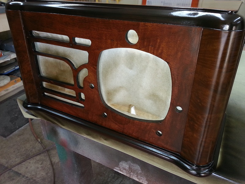

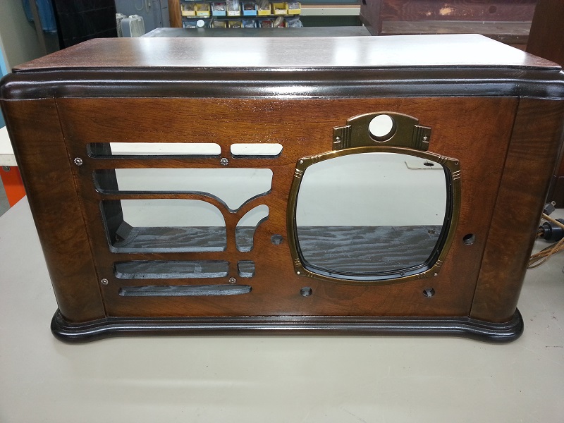

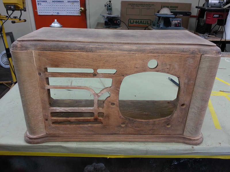

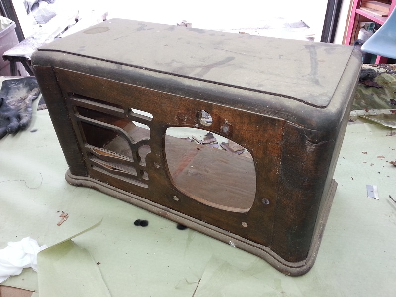

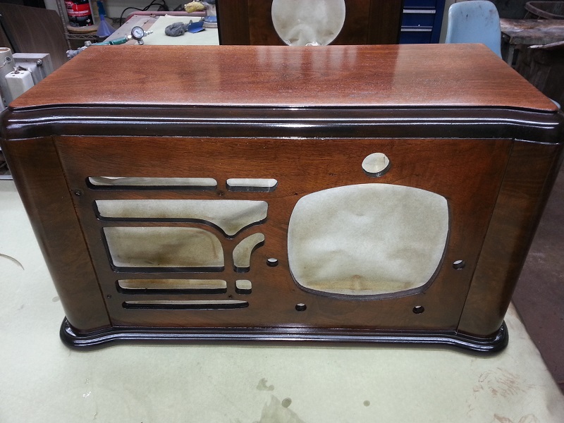

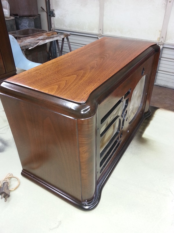

Picked this up 2 weeks ago a finally finished the cabinet . Its was pretty rough and Kirk thought is was a fire victim, it wasn't burnt looked bad , the veneer on each side on front had been replaced along with both sides. Look presentable now have to finished the chassis later next week.

Amazing change.^^ I thought for sure you might be pulling your hair out repairing the columns in front.
And whoever redid the veneer on the sides and top seemed to have gotten the veneer type correct. Some of the tops Ive seen and worked on may have been more figured veneer but someone would have to be pretty anal(myself included) to spot that slight difference. Very pretty radio now and it will play great!
(11-05-2015, 08:52 AM)JimZ Wrote:  Amazing change.^^ I thought for sure you might be pulling your hair out repairing the columns in front.
Thanks JimZ , the top and front control panel is factory veneer, the sides and L/R column's is what I replaced .

So you did do the columns..whoops I misunderstood Fred. She's a beauty.

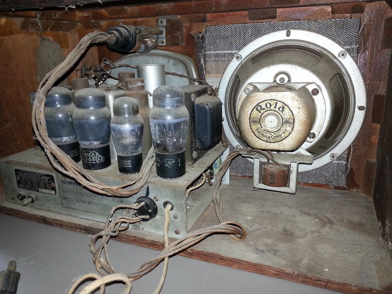

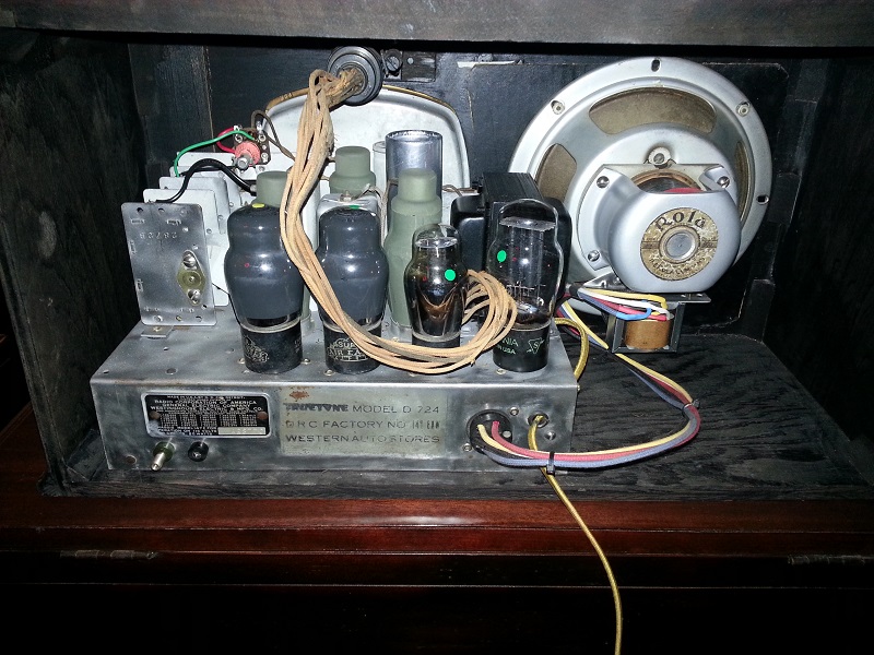

I dont like the highly polished escutcion either , there not suppose to be like that, mine was pretty bad so cleaned it up and recreated the patina. With my radio the antenna coil is bad and audio out put push pull transformer for speaker is open so I have order new at antique radio supply. Should be here this week. The chassis was real nasty also so I had to carefully  bead blast and repolish chassis best as I could. I will update this post as I go along with radio or when finished.

I have an exact model in the queue for cabinet restoration. The veneer is slightly lifted at the front on each of the verticals on the sides. Did you have this problem?
The veneer was shot on both sides when I got my radio, these sets are know to having the veneer come loose on the sides, its common from what I understand so most guys will replace or repair what you have

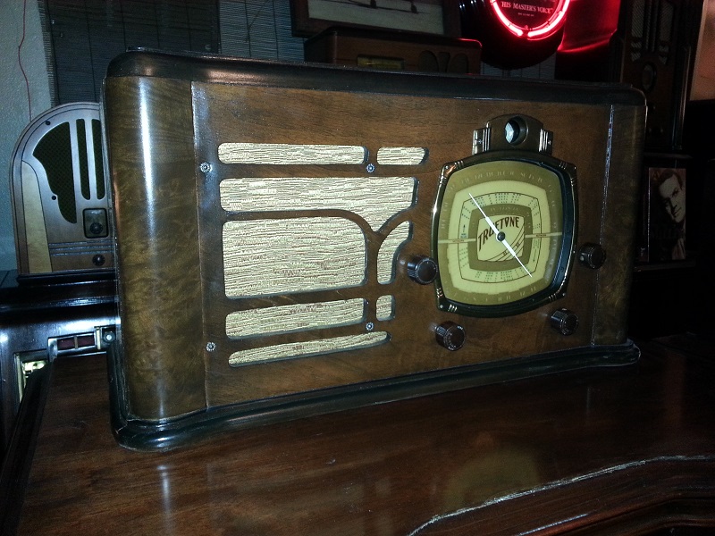

Almost finished, I am waiting on dial cover though, I put in new antenna coil and replaced electrolytics also replaced speaker wires along with the speaker push pull transformer. Got it playing pretty good and put it in cabinet now nothing , well time to pull it out and poke around some to find the problem. Overall this truetone turned out pretty nice. Had to make a grill cloth backing board which was nothing to speak of, im wondering if I should get a repo dial scale cause this one is seen better days?
Hers what the chassis looked like before surgery Icon_eek Icon_eek
Looks very nice Fred!
