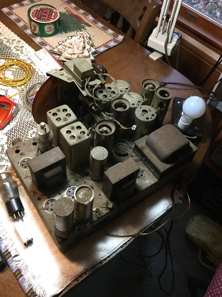

Ron, can you please identify this 116 chassis?
I want to order the proper service literature for it..
Yes - as it has a short power transformer and 6-pin sockets on the left for type 42 tubes, it is a 116B Code 121 chassis.
116X Code 122 sets have a thicker power transformer (more iron), and the two tube sockets along the left edge of the chassis as shown in your photo would be 4-pin sockets for 6A3 tubes.
You may find this page useful as you service your 116:
http://www.philcoradio.com/tech/116.htm
It outlines undocumented changes to the 116 AVC circuit.

Wait - hold the phone, folks.
No, I'm not that good...once again, a case of looking at something right after getting up... Icon_redface
Let's try this again.
That chassis has round tube shields! Icon_wtf
Brenda, can we see the front of the chassis, please, showing the dial scale? From the back, the dial setup looks like a 116 but the chassis itself looks more like a 16 Code 125...
And can you tell me this: Does the band switch have 4 positions, or 5?
