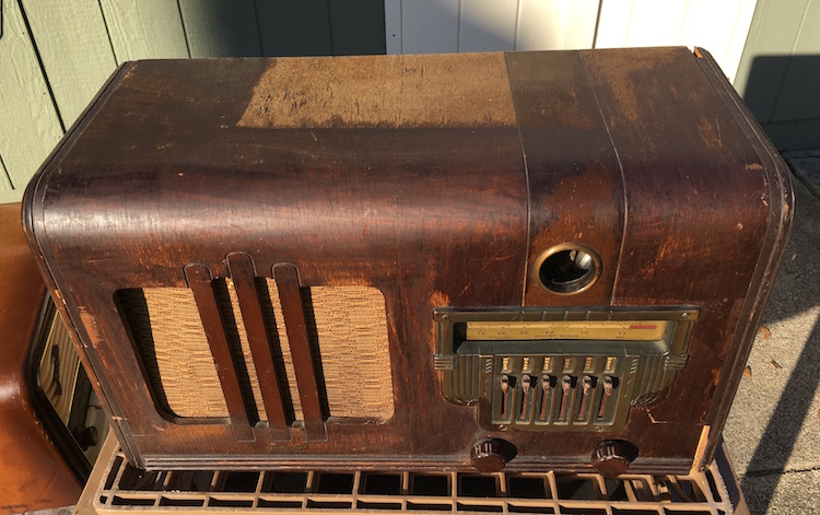

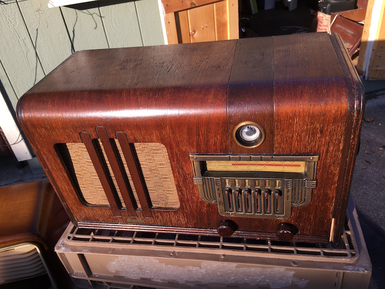

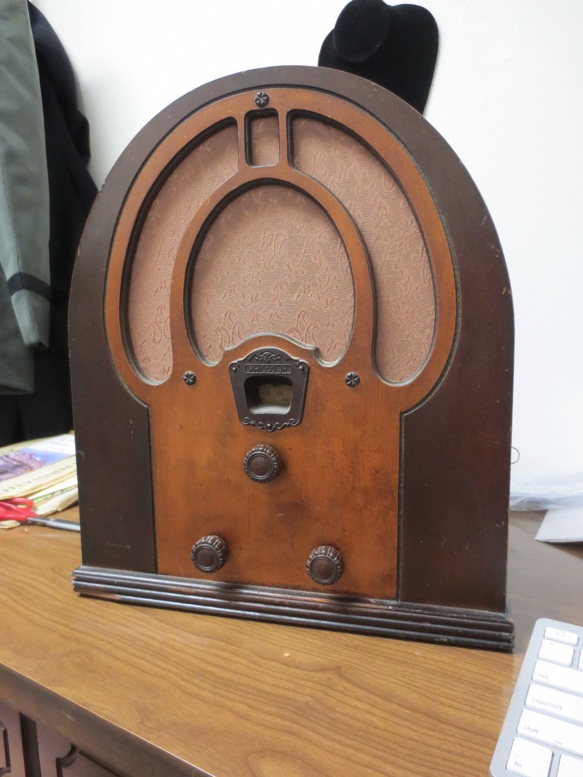

Here's a photo of an 81 in Ron's gallery showing the lighter center and darker outer sections.  I believe the 81 is very similar to the 80 in color.  Here's a thread where Ron suggests Mohawk toning lacquers in the colors of Perfect Brown Ultra Classic for the outer section and Medium Walnut for the center.
Toning lacquers and clear lacquer were used for finishes, not stains.  Some folks use spray machines some use rattle cans depending on their skill level.  There are threads in the cabinet section on how folks have restored cabinets.
Here's a clearer picture of an 81 from a recent eBay auction that looks like it has the original finish (looks like wrong grille cloth though) - and I don't see a decal. I would guess that because the escutcheon says 'Philco' there wasn't a need.

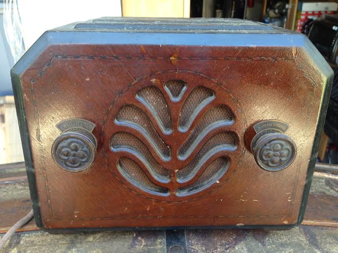

Does anyone have any information about how to repair or replace the trim on the bottom of the cabinet? Mine has a small piece broken out of the bottom corner. Similar to the one pictured above. I didn't know if there is some source for this type of trim or whether I would have to fabricate something.
Two cabinet part makers are listed here: http://www.philcoradio.com/resourceb.htm#c
I know Steve makes trim though not sure whether for 81 or not.

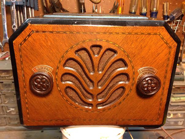

Not for nothing but what is wrong with that cabinet? I dont see any real issues.
It is very dirty but no veneer issues, No gouges, no real finish loss.
Have you tried the GoJo method of cleaning?
It is amazing..
See below.
Kirk

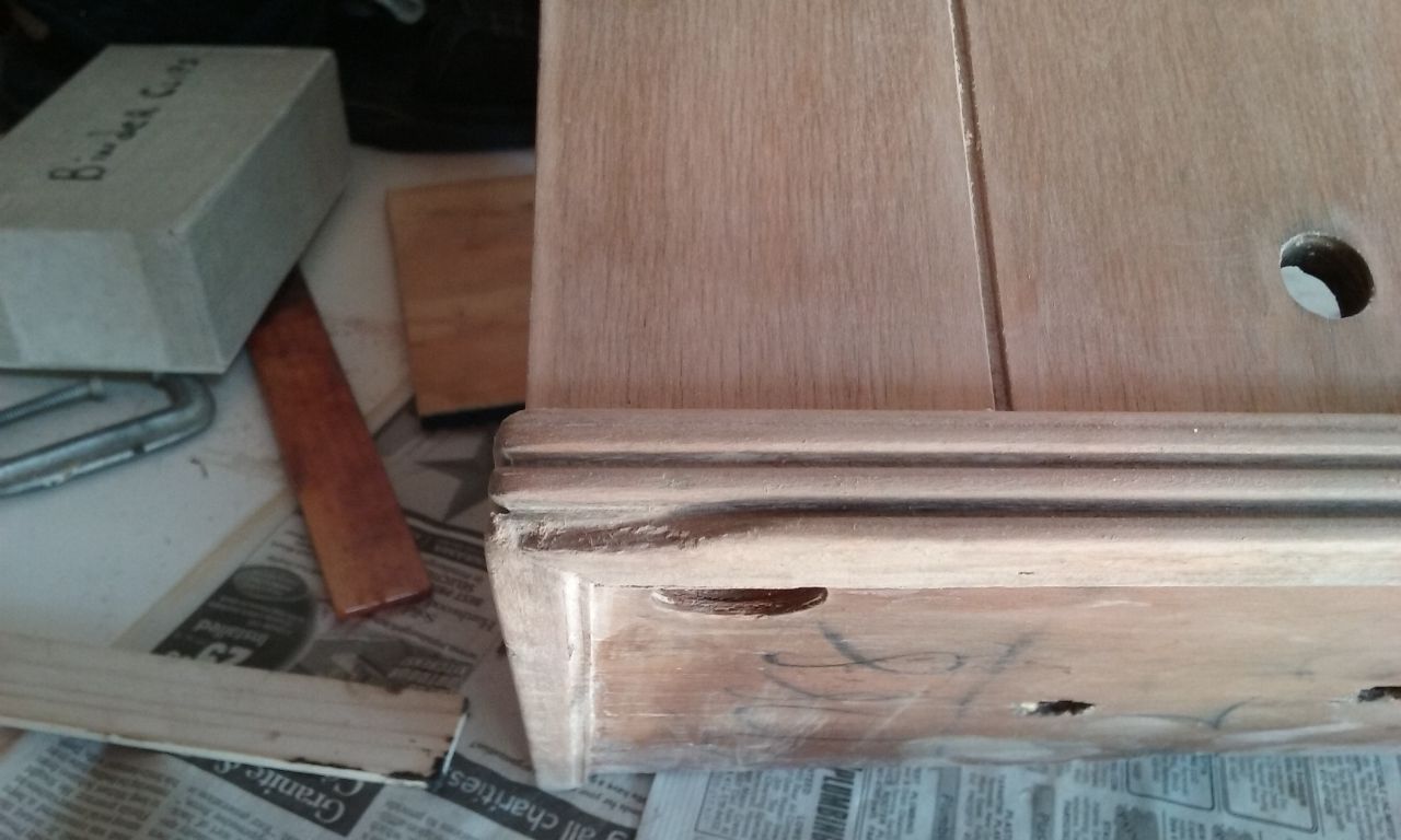

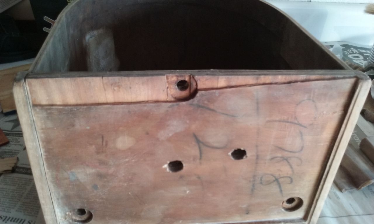

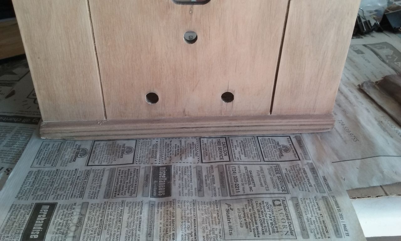

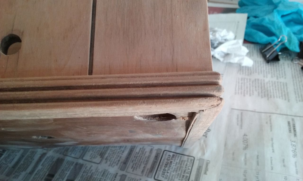

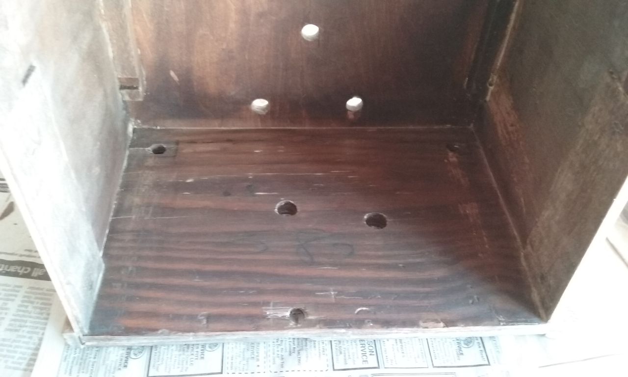

I am trying to decide whether to replace or repair a couple of items on the 81 Jr, I have been working on and would appreciate your opinions.  These are the cabinet bottom plywood and the trim around the bottom.  Below are some photos of how these currently look after stripping.
The plywood is missing part of one layer on the bottom, but could be repaired.  Since it is on the bottom, you really won't see it.
The trim is really only bad in the front bottom edges.  Mostly on the left.  I didn't know if there is some way I could build this area up with wood or filler to repair.
Please let me know what you think.
Thanks, Bill
I'd just fix it. It's not too much work or time to do it.
