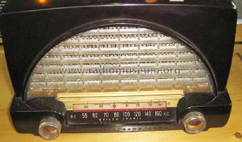

i just bought a philco transitone tropic model 3010-123... and being more than 70 years old radio there
is some rust and a lot of dirt.

a photo of the radio is attached which i found on radiomuseum.org

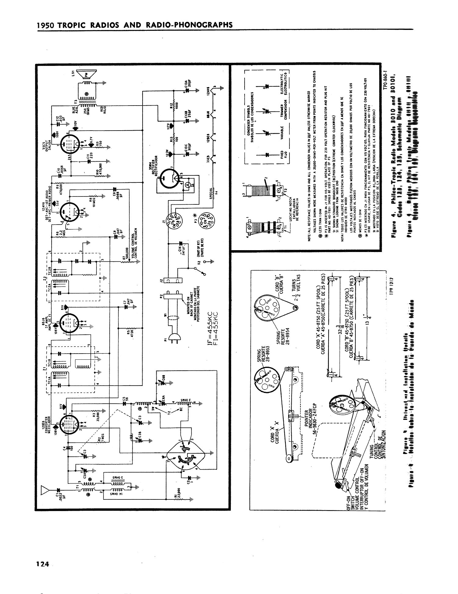

Hi Aras, I'm not sure if it is going to be a match for your radio, but I did find the schematic and information for the 51-532 in my Bateman's schematics. I am attaching it as a JPG file for you.
[Image: http://40.media.tumblr.com/4289ef751ec9a...1_1280.jpg]
Your 3010 does include a 12AV6.
If you can give me a little time, I can scan and send you the 3010-123 service info...may be a day or two before I can, though...

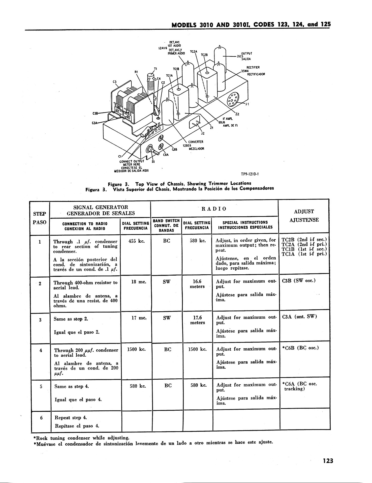

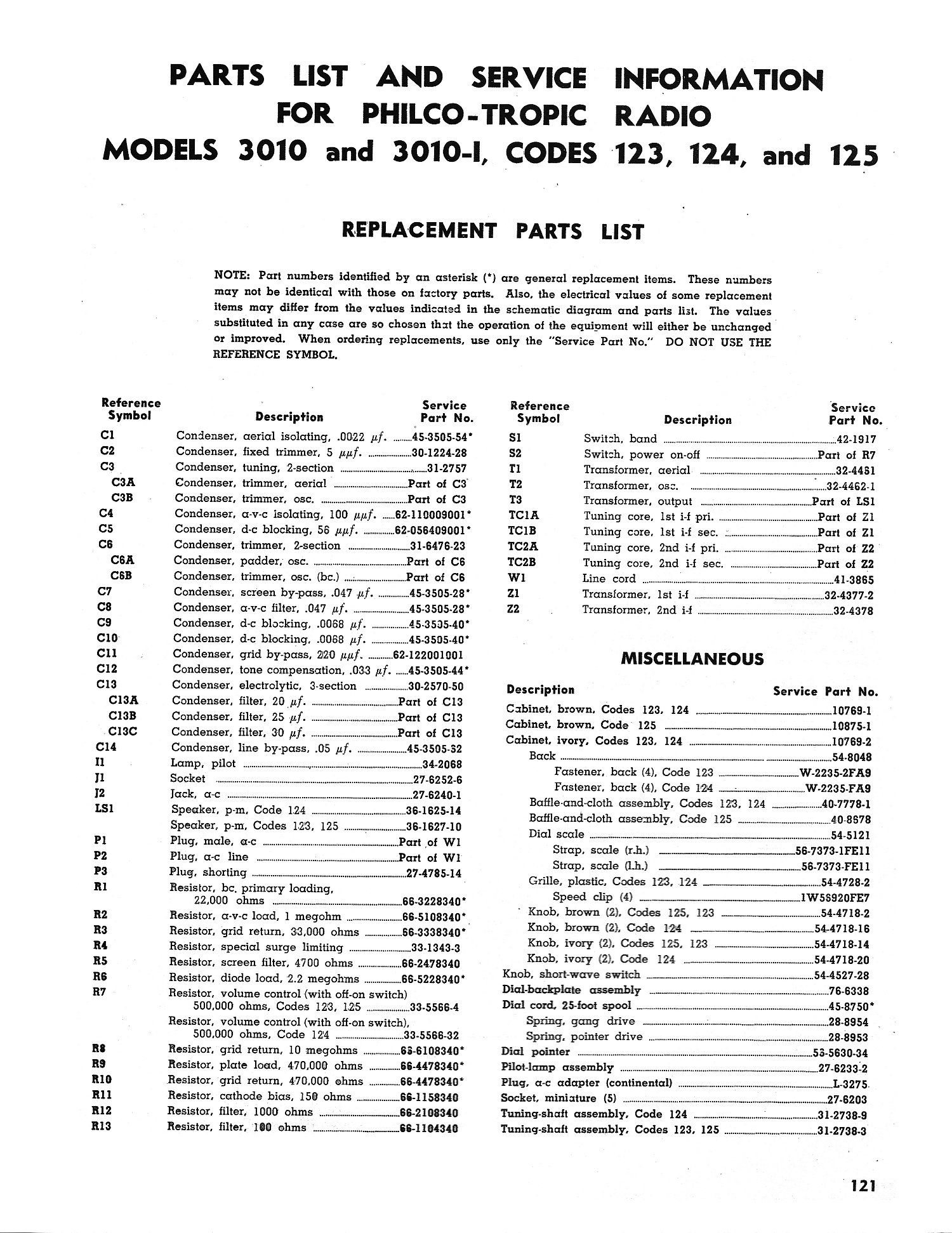

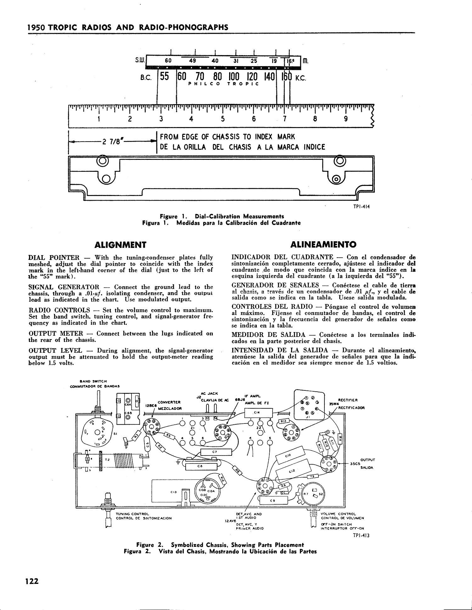

Here you are, grundigman3000:
http://www.philcoradio.com/images/Tropic_3010-123.pdf (High resolution, 4 pages, 24.8 MB)
Please let me know when you have this so that I may remove it from the server.

Try this - individual files of each page.
http://www.philcoradio.com/images/3010_pg1.jpg
http://www.philcoradio.com/images/3010_pg2.jpg
http://www.philcoradio.com/images/3010_pg3.jpg
http://www.philcoradio.com/images/3010_pg4.jpg
Not as high in resolution as the PDF but should work for you.
I got it......thank you so much.......

its mentioned in the part list that R4 is a special surge resistor and its missing in my radio
what would be the value of such resistor??
