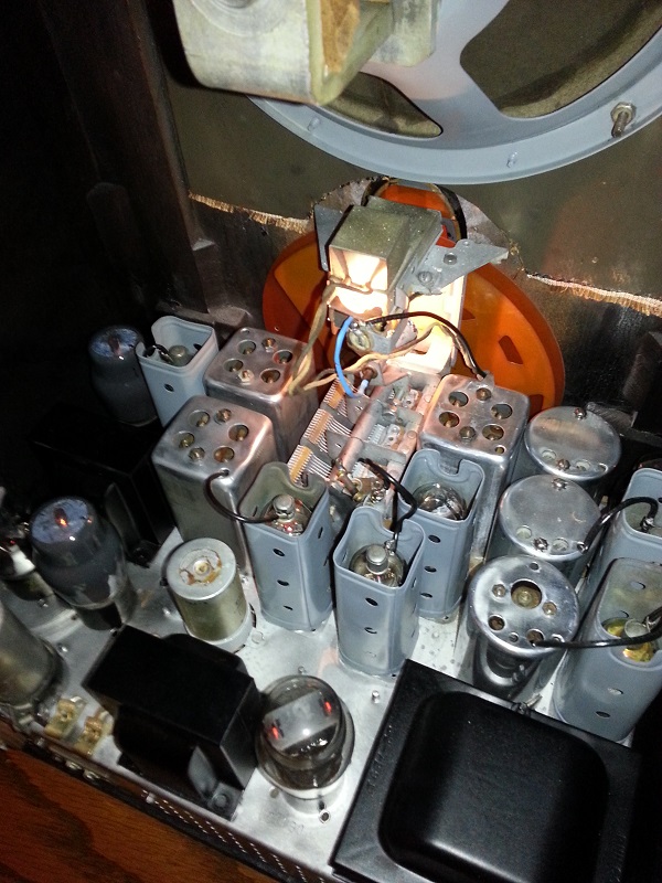

Here are a few pics. of the chassis removed. I was happy to see it looks like no one has worked on it before no by-passed bakelite blocks etc..
[Image: http://i1336.photobucket.com/albums/o654...bxa52l.jpg]
[Image: http://i1336.photobucket.com/albums/o654...dh7wtj.jpg]
[Image: http://i1336.photobucket.com/albums/o654...qa9bxu.jpg]
Thanks to everyone that commented.

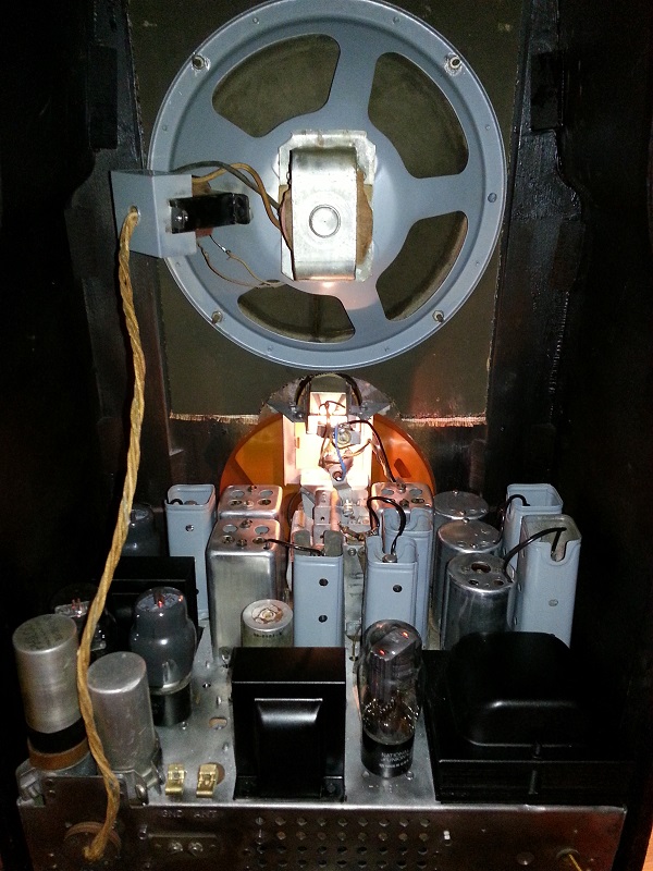

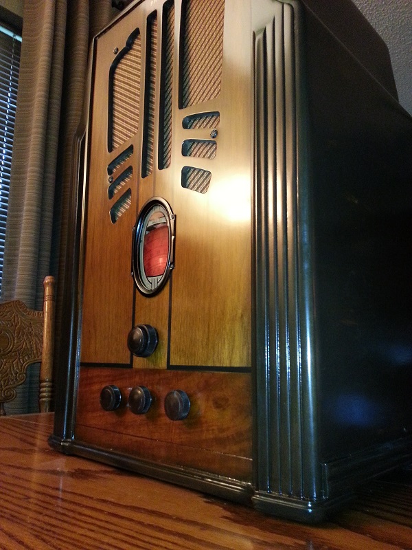

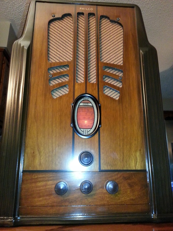

Been making progress on the chassis. Restuffed all the paper capacitors and E caps, had to replace some of the resistors that were too far out of tolerance. I went ahead and powered it up last night before installing the big dial scale just to see  . I was able to pick up stations across the dial. So started on the final stages of getting every thing reassembled Just wanted to show where I'm at so far.
Here is a photo of under chassis before
[Image: http://i1336.photobucket.com/albums/o654...nw4vzf.jpg]
After:
[Image: http://i1336.photobucket.com/albums/o654...4takqe.jpg]
Top side before:
After:
[Image: http://i1336.photobucket.com/albums/o654...w5tzav.jpg]
Hope to get it completed by end of the week.
Thanks for looking
