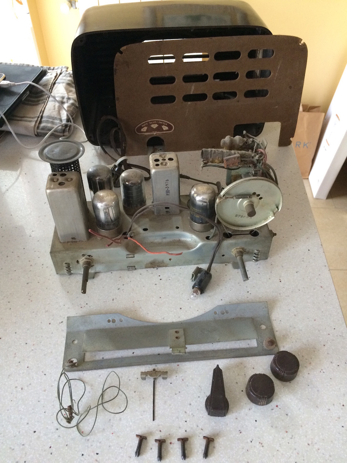

Deputy photographs radio I have, and what I need to know (with some photos, or documents), as is the detail is fixed:
1 When the speaker chassis.
2 The metal strip where the dial needle slides, speaker.
3rd transformer speaker, the speaker itself.
My intention is :
1º- Locate a speaker 4 "x 6", permanent magnet and an output transformer speaker.
Modify 2º- filter power supply, replacing the original speaker coil by a suitable power resistance.
Mount 3rd secured to the chassis, the set, transformer, speaker and metal strip through which the needle slides dial and dial montra rope for signaling dial needle work.
So I ask for help, for details of how fixed to the chassis of the radio, speaker, speaker transformer, and the upper metal needle tita where this radio dial slides.

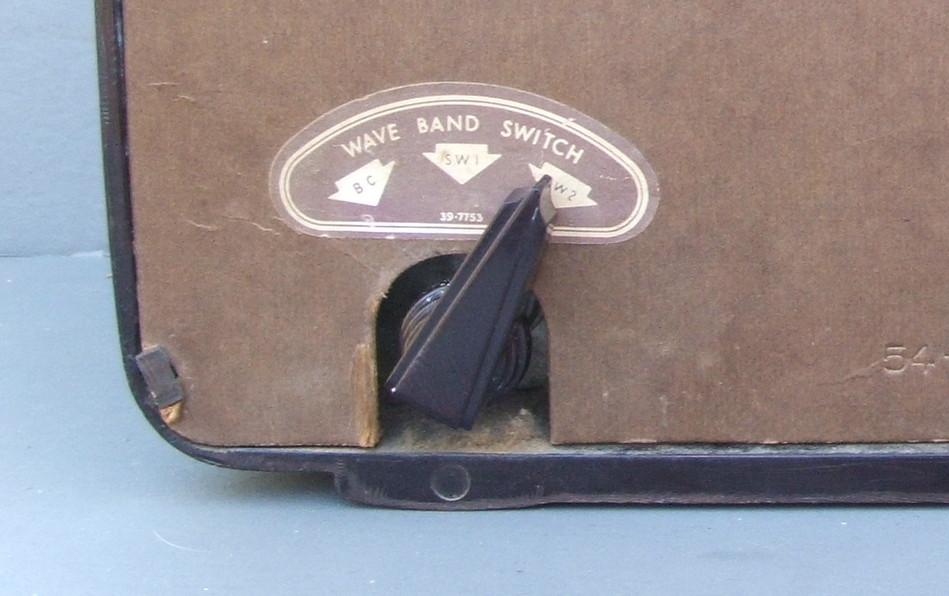

The "beak" knob does not seem to belong. It is from 1937-1938 radios for band switching.

Hello morzh, as you see the "beak" knob  if it belongs to the radio.

I don't have one, so this is just an educated guess.
The speaker - which has an unusual large metal frame and is probably specific to this model or a few similar models - is most likely bolted to the chassis where the two clear strips are just behind the indent on the chassis (probably mounted from the magnet area - you can just see one in this photo http://postimg.org/image/zdvzpr5nh/ to the right of the IF can), and the dial assembly is bolted to the top of the speaker.
The speaker is part of the mechanical assembly for the front of the radio, almost like the engine in a motorbike often forms part of the frame... so not having the original one might be a problem. If you do not find an original speaker then you will need to make a suitable bracket(s) to mount everything in the correct place. I suspect those speakers will be very hard to find unless you can find another radio for parts.
