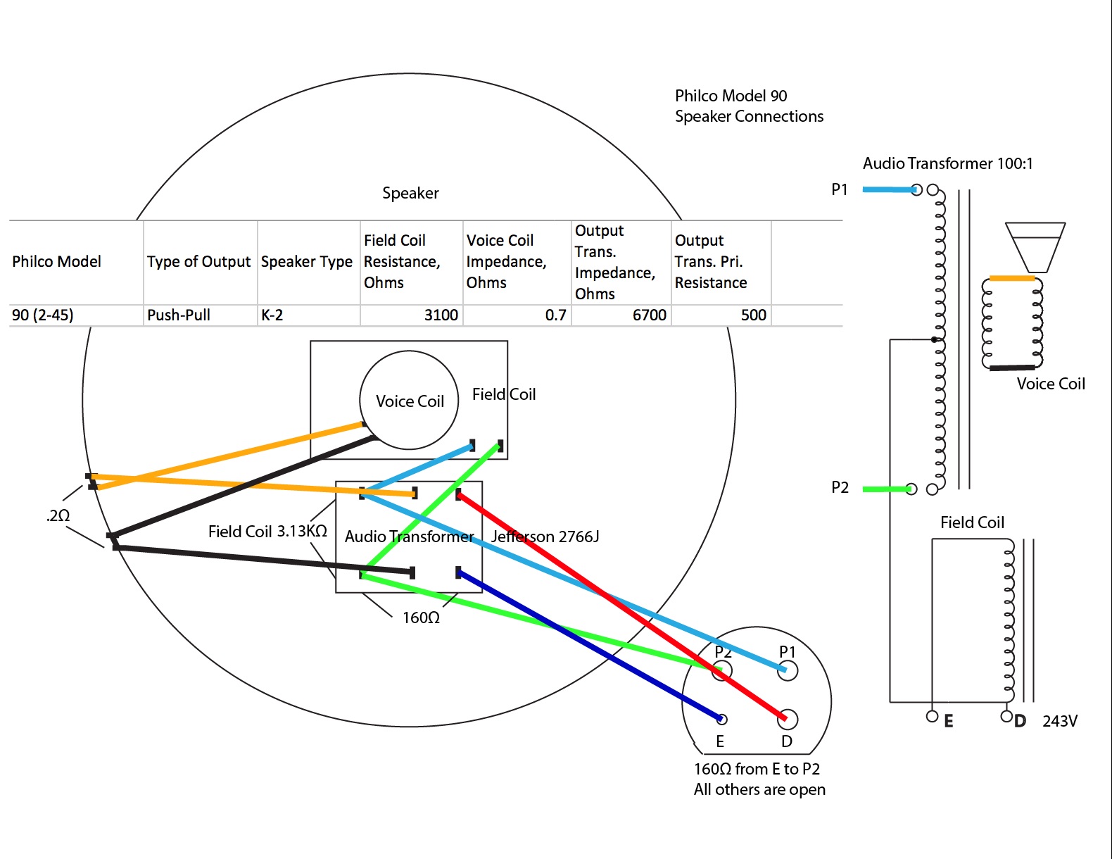

Thanks Arran for the input. I will remove the transformer later today and test it. Here is what the wiring looks like now:
But this doesn't make sense to me...

Hmmm. I think the drawing you refer to is for single-ended output (one pin is not used). For push-pull output all pins are used.

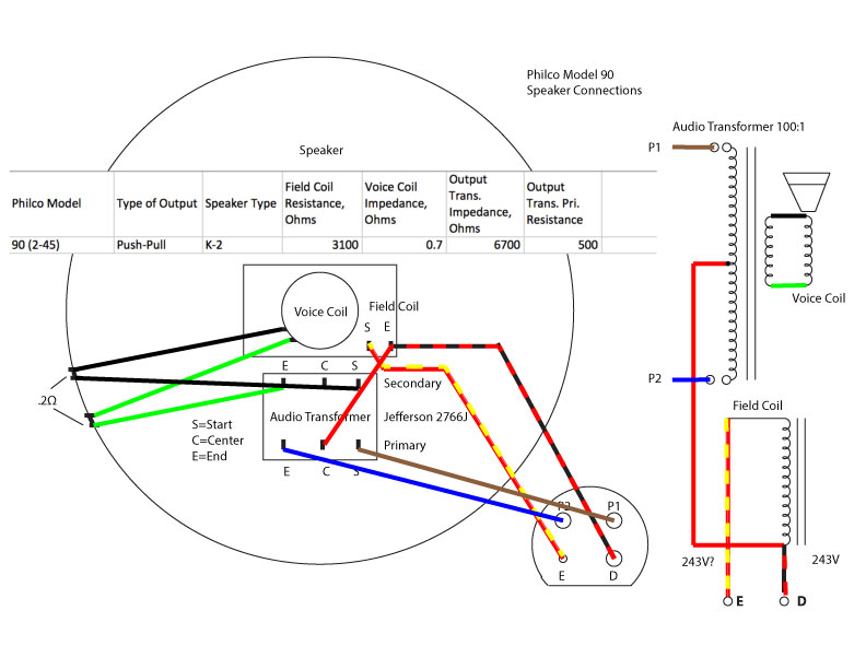

Based on the schematic (as shown at the right side of this illustration) I was expecting the wiring to be something more like this, perhaps I'm wrong:
It doesn't matter, with cut side down the top two pins are ALWAYS the field coil.
In your case:
If you look at pins from the front,
P1-P2 are field coil.
P2 is also the center tap of the xfmr primary.
E and D are the Pushpull ends of the primary.
Or as Arran suggested: it is grossly miswired.
PS. It is also possible that whoever fixed the radio the first time also miswired the chassis socket and then wired the plug to fit.
You have to see what chassis is like.
PPS. I'd still made the wiring standard lest you one day burn a perfectly good speaker plugging it in your chassis.

Thank you for the clarification. In the first diagram, I am showing how it is currently wired, I have traced it in the chassis and through the speaker connection. If convention is that the top two are the field coil, then I will rewire the chassis as well.
Here's how it currently looks (note: the interstage audio transformer has been replaced by a phase inverter circuit--at least that's what it appears to be):
To be honest....?how do I know which pins are top and which are bottom?
You have the actual chassis, it is easier for you to look at it.
If I were to think the two inner pins are at the bottom (well the chassis is upside down so right now they are at the top), but I mean one fat and one slim pin, they have to be pushpull xfmr ends.
The two outer pins (two fat ones, again I am making a supposition) have to be the field coil. One of them also receives the centertap. (If you look at the plug, the top left fat one connects to both field and center tap).
It seems to me that if my presumtions were correct, your chassis is miswired same way your speaker is.

Yes, the two inner pins are at the bottom (they are labeled with T's & B's in the diagram for Top & Bottom). I agree that chassis and transformer are not wired correctly. I was unaware of the speaker pin wiring convention that you clarified for me, and I appreciate that. Thank you!

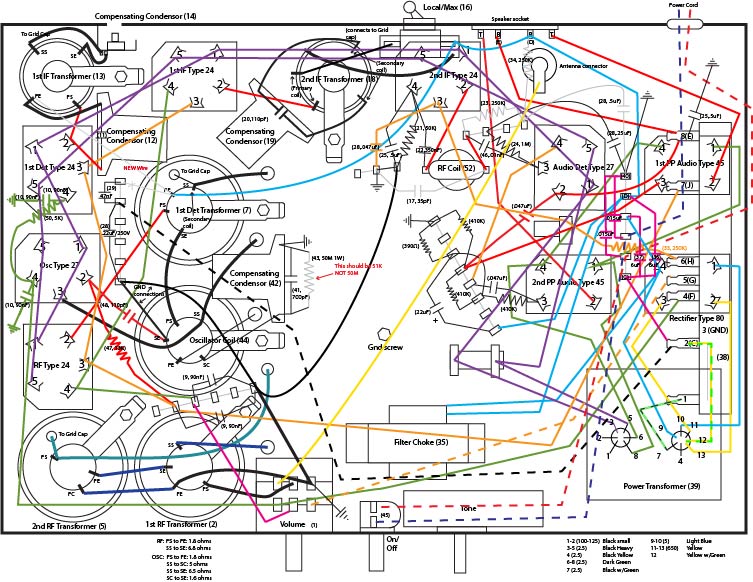

I made this rat's nest diagram to help me in identifying the connections as I trace through the circuits (and to make sure I know which tube pin is which). I'm using a signal generator, a 'scope and a signal tracer along with voltage measurements to identify problem areas. With the diagram and the original schematic I can usually keep track of where I am in the circuit analysis. Also, making the diagram helped me to find incorrect values for some components, missing components, and miswired connections.
