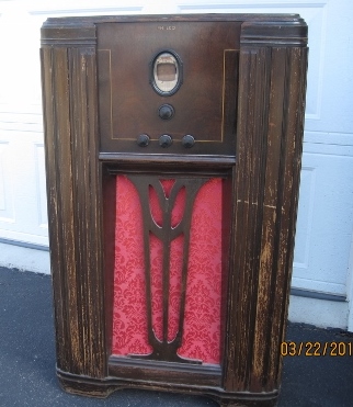

Okay, so I did buy the 630 console yesterday.  I have less than $ 20 invested in this thing.  And the best part is no shipping damage to it because I drove over and picked it up!

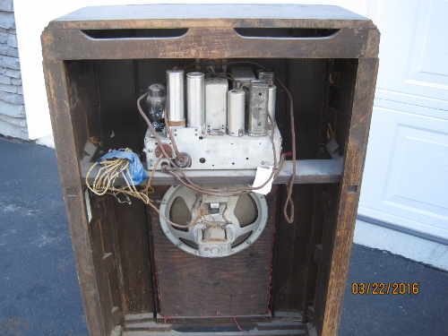

I'm not sure when I will start into this one so it may sit in the garage for a couple months until then.  At the very least there are a lot of good parts in it.  All of the parts seem to be there, even the shadow meter.
G.
Even if the speaker did not work that would be a very good deal. Clean chassis, a radio with a shadowgraph......

A lot of good parts in that chassis
Looks to be a very restorable receiver. The cabinet does not look too bad either, very restorable. Should be a fun project. I look forward to your postings and progress when you work on it. Great find and a good price. Good luck with it.

This console sat all Summer and Fall until this week when I started to look at it.  So far Iv'e replaced the 4 electrolytic caps, cleaned the bandswitch and tested the tubes.  Today with a dim bulb tester, I slowly tested out the chassis and found everything seems to be working pretty well for an old 1936 console.
I know I will have to replace more capacitors and resistors to get it tuned up and working well and this will be done over the next few weeks.
