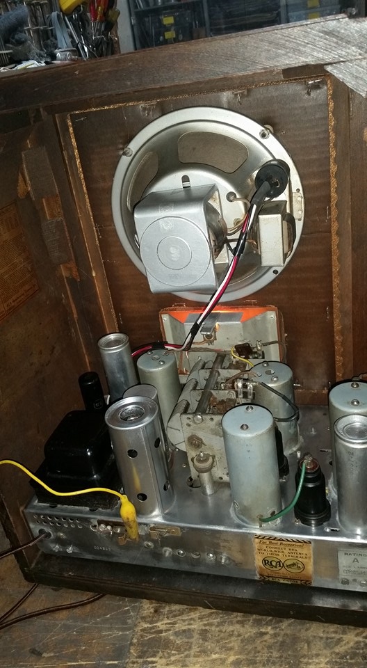

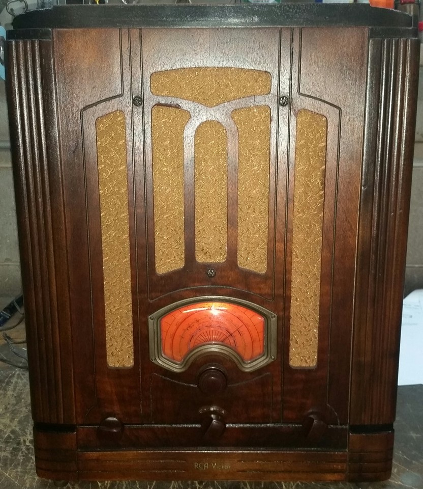

So I was finally able to take those pictures I set out to do Friday night... my cell phone doesn't take the greatest of pictures but I wanted to snap a few while I had it playing on the workbench....

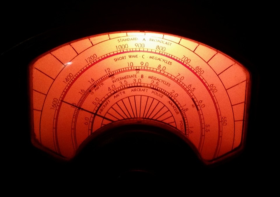

Radio Daze did an excellent job reproducing the dial scale....

What a beautiful old set ! With the RF stage I am sure it is very selective and sensitive; those old RCA sets were; and, with complete coverage from 550 Kc to 19 Mc you'll have a lot of fun. Congratulations !
Very nice Icon_clap Icon_clap Icon_clap
