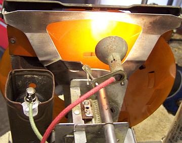

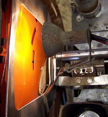

Yes, the vertical lens is in place.  I have attached some photos of the dial appearance as well as the position of the lamp hood.  Perhaps the dial lamp hood should be more centered vertically and horizontally? If the light hits more to the side of the vertical lens perhaps that causes the lack of focus? The lamp hood is off to one side and also appears to be too high.  I wanted to find out from some experts before attempting to bend the bracket (and with my luck, break it!)  Thanks.
This lens simply focuses the beam.
So you need to 1) make sure the dial is in focus of the lens, 2) the light bulb's filament oriented such that it creates a vertical most narrow line. If you need to adjust something - do it. Just do not break the glass rod.
The lamp and reflector is definitely too high and off to one side. It appears the bracket is bent, as it should be perpendicular to the dial.
The lamp should be directly behind the glass lens and centered vertically with respect to the dial scales. Otherwise the lens will not focus the beam indicator sharply.
