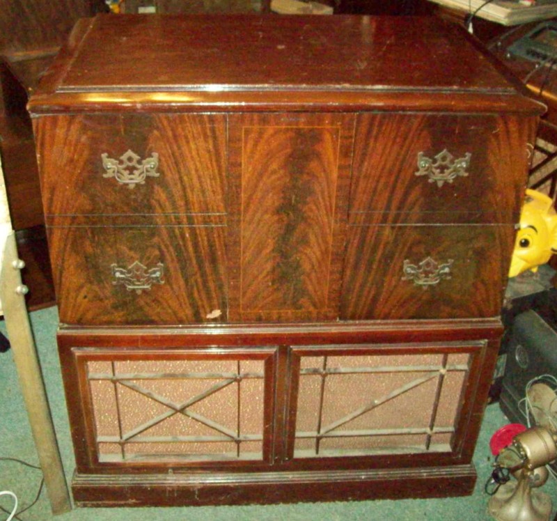

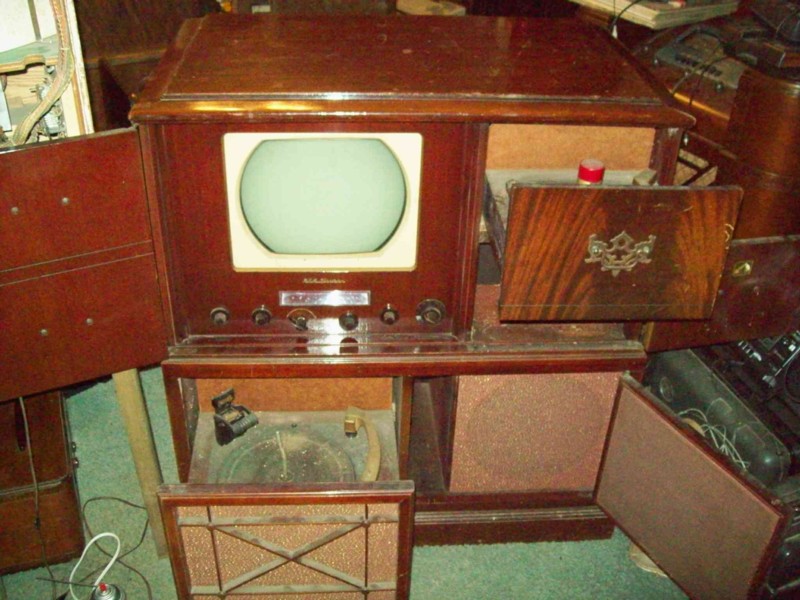

Well, here are a couple pictures of thise beast. It was about all my dad and I could do to get this thing up the steps and into the building. On the plus side it looks to be about compete with only a couple wires to repair. It also has an odd, one switch remote plugged into a socket on the back of the chassis. I've seen those sockets on other RCA TV chassis, but this is the first one I have found with something attached! There does seem to be a rare thing about this set, it appears that the CRT is attached to the chassis, meaning that the radio/TV chassis and tube can be pulled out in ONE unit. Heavy, yes, but it makes it easier to work on as the CRT and yoke can stay attached.
BBuster aint it!!!! It's good if the crt is fixed to the chassis my '50 16"RCA (KCS-47A) set it's fastened to the cabinet. Makes a little more of a  challenge to service. I made up extension cables to power the crt and yoke. I learned that the insulation was a bit lacking for the anode lead, I won't tell you how I determined this. OUCH!!!!! I'll mention in passing if you are servicing it with the spkr/opt disconeted put the output tube (6K6?) Having no plate volt but retaining the screen grid voltage can damage the tube(s)
GL It's a fair amount of work to get it going properly.
