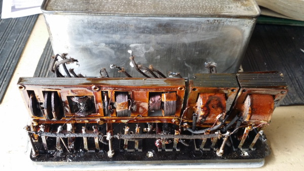

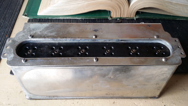

I think some people call this a "catacomb". I call it the formally potted IF, detector and audio sections of a Radiola 25. Just thought you might like to see what is inside without having to remove the wax.
I replated the metal box and top.
Will post finished pictures on my blog.

Oh geez.....I don't wish that upon muyself. Hate coils.

This is a super. Supposed to have I stage of RF. So the transformers from the left are:
Primary (thin)
Secondaries that are CT (thin side by side)
Spool that is pri and secondary
IF primary and secondary
End of first core which is common for all above.
First audio
Second audio

That must have been quite a challenge to un-pot the wax without damaging any of the coils. Good job.

There are about half a dozen mica caps and 1 carbon resistor inside of that assembly, but the most common failures are the audio interstage transformers. Now, having said that, I just emptied that one to look at it - yeah, I know.
I did end up replacing all of the cloth covered wire. It was getting crispy. And I replated the can and the top metal around the tube sockets. It looks much better and I could not have done it with the can still potted.
I will tell you that the catacomb can be drained without making a mess of the tube sockets. Trick is that you have to remove the can top, which is formed and soldered in place. So this is a bit of a challenge by its self especially if you want to but it back on. Turning the housing so that the wax drains away from the tube socket board. I can't imagine cleaning the hard wax out of the sockets and wire connections. You can see the top of the can in the second pic of the first post. It has been reassembled at that point.
It is all back together now. I'll probably fire it up in the morning.

RCA really did not want people going into the catacomb box. Beside the potting, they used lead seals, embossed with the RCA logo inserted into some of the rivet holes. It would then be obvious if anyone opened or tampered with the sealed enclosure.
I opened up one of these boxes many years ago and was amazed at the lengths RCA went to to conceal what was inside. Don't know what they were thinking, as anyone determined to do so could get inside and see what was there.

I put the two led rivets back. I did not notice an RCA stamp, but they are very soft.
