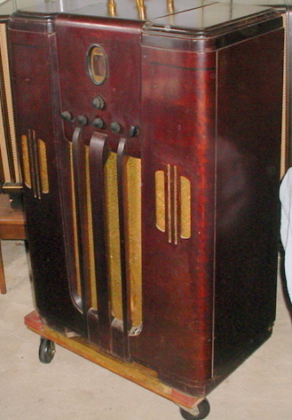

As promised here are a few pictures of my  680. I shot these on a very old camera so hopefully they are not too wide. if they are too big someone PLEASE let me know. thanks. BTW couldnt get it out of photobucket
 The cabinet looks to be in good shape. Should clean up nicely. Icon_thumbup
 I wonder if someone had that cabinet refinished at some point during it's life? The finish has a sort of dark mahogany red colour, and the speaker grill bars are that same colour. The grill cloth, or cloths, have also been changed, the original cloth used had a chevron or "V" shaped pattern.
Dont think it was refinshed grill cloth replaced for shure  is anybody selling the correct cloth for this? BTW only put one picture because I could not get them out of photobucket. Thank you Norman
