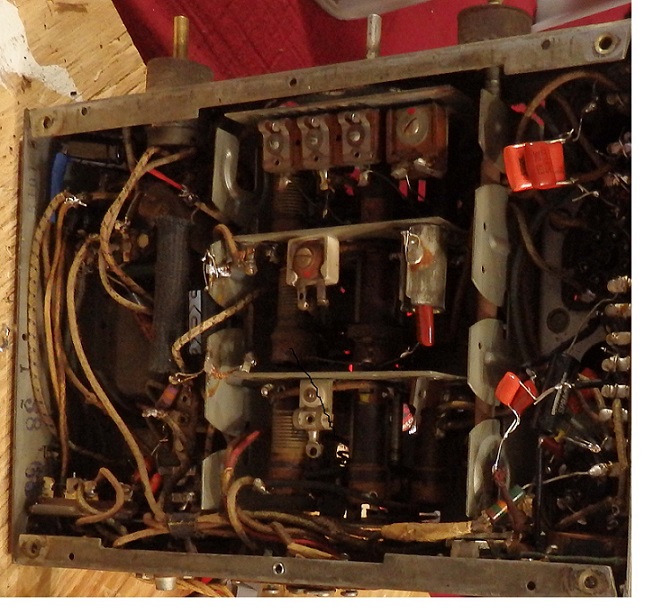

Hello Im trying to recap this chassis and I cannot find the value for philco capacitor 30-4317. Not shown on schematic. My chassis does have the bakelight cap move update 3793-dg moved to rear of chassis.

Ok I ordered some .015 caps but didnt check that 3793 was the power line caps. Saw on just radios that there are x1y2 caps, ect and I have no idea what x1y2 or just y2 is other than safety caps. Main issue with this set is it just sounds distorted and not sure why yet. Seems like it drifts and gets distorted. Grid cap somewhere?
On the 6a8 tube I see a resistor that has a measured 100 ohm across pins 7 and 8. Cant tell what color its supposed to be since its way down in the center section. Also dont know if I must remove the center section to expose more parts that could be bad. I only see two caps in there, are there more resistors and caps under this center section tuning platform?
Total things I have done so far is replace the power supply B+ with caps rated at 450 volts(just saw that the working voltage might need to be higher?). Cleaned all the tube sockets as the tubes were a bear to remove. Replaced the 30-4446 as it seemed to be open .25uf

will keep looking for that cap replacement trick.  Just happend to notice the alignment page.  Right under the knobs there are 4 trimmer caps.  1 big and 3 smaller ones just like underchassis picture.  In the middle of the chassis theres supposed to be 3 small ones(only has one large screw trimmer), and twards the rear supposed to be 3 more(only has one small screw trimmer cap.  The center, and rear only have 1 trimmer cap.  how many different versions of this 37-630 are there?
Beginning to wonder if this is a 37-630 chassis at all since its missing trimmer caps.  It does have the same tubes and layout of the 37-630.  The console cabinet itself has the 37-630 sticker in it.  Wish I could post a picture on here but haven't figured out how yet.
Have now replaced the 2 under tuning gang caps.  Removing the tuning gang wasnt that hard, reinstalling it was ....insert colorful metaphore here.  Replaced 2 weak 6k7 tubes with nos and replaced the 6q7 as well.

Ok everyone was waiting for this. 37-630.....CODE 125! Haven't worked on philcos since 2002. Found post on philco removing some trimmers. Now if I just had the schematic I could try to do an alignment.
