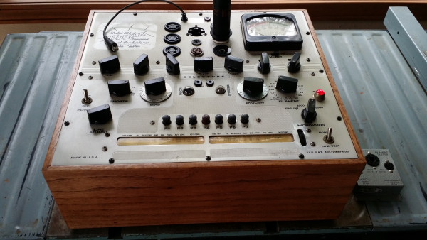

I have a tube tester I am restoring that has a wood cabinet covered with the Tolex. I have zero experience with this, so I am hoping for some tips before I grab the glue bottle and start smearing. I don't know if it would be best to try to simply re-glue the existing tolex or rip off and replace.

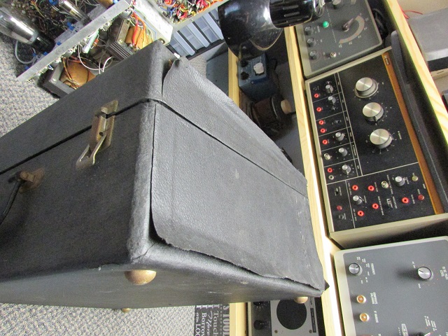

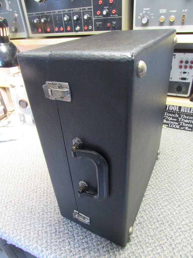

There is absolutely no reason to re-cover. Spray adhesive on both pieces, wait a few seconds and bond.
I have saved many coverings this way..
The one below was peeled half way off all around...

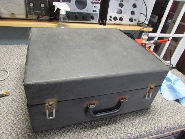

Other then the glue letting go near the edges the oil cloth/leatherette looks like it's in fairly good shape so I would try gluing it back down rather then recovering the case, recovering the case would be close to performing a re-upholstery job. It may be a good idea to clean under the areas that are lifting before gluing them back down, glue doesn't stick well to dirt and dust.

It feels like the rest of it is pretty tight on there. I have some Tolex glue and I also have some spray glue. I think I will try the tolex glue 1st and see what kind of result I get. Looks good Kirk! Thanks for sharing! Got some rusty hinges and clips to deal with also.

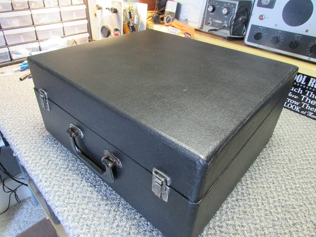

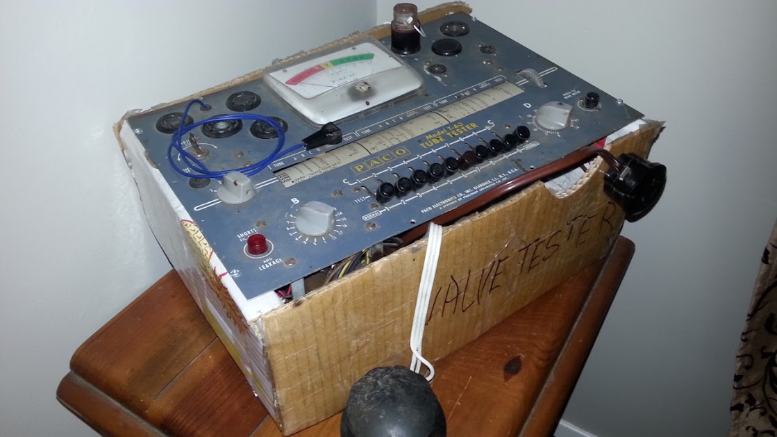

With the Electronic part of this restoration finished, I have moved on to the cabinet. The hardware is rusty. Some of it cleaned up nicely with the wire brush on my Dremel tool. Some didn't. The tolex appears to be fairly poor quality, and the install not so good either. I am debating on recovering or re gluing. Several tears and cracks, corners torn off, etc. AES has some hardware, like the feet and a handle, but I haven't found any hinges or latches. Does anyone know where I can find these items? Or even what terms to use for internet searches? This isn't for show, but I do want it to look decent.

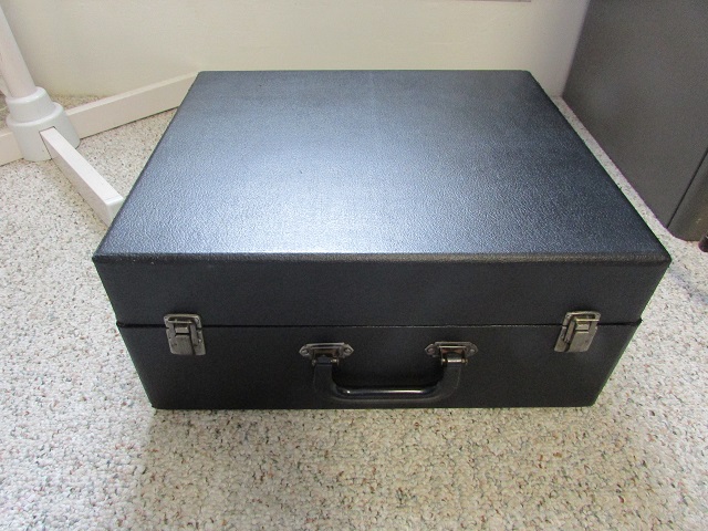

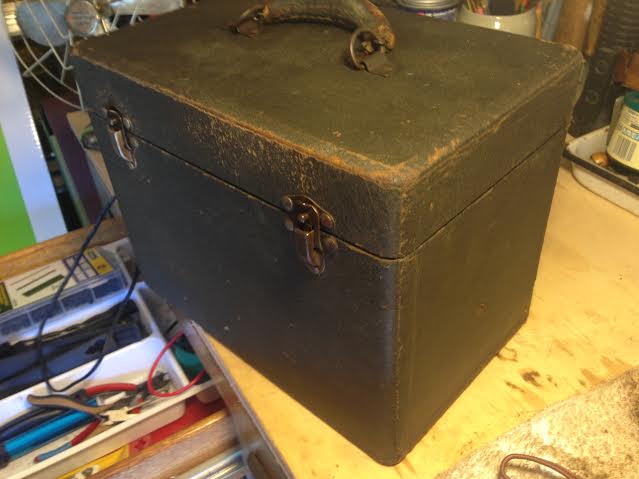

I have started the repair. Note: repair. I decided to try regluing the tolex first. I used the tolex glue from AES. I will post the results later.

That is Fantastic!

 stunning transformation! Awesome job...
