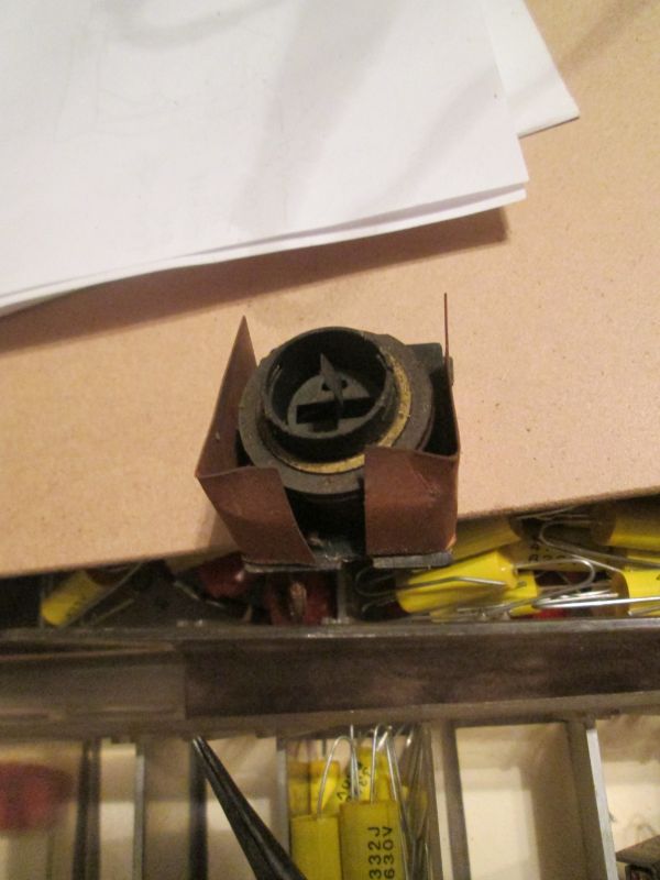

Was reading some posts about the shadow meter and was inspired to pull the one on the 660 off. Got it off ok but don't quite see how to get the vane and it's pivot plate out with damaging it so I can mount it on a spindle. It also looks like there are 5 dinky brass tabs at the back of it (where the wires are solder on) and I'm guessing that I pry those up to gain access to the backside of the coil. Dang it's got a LOT of wire on it!!!!

So I'm assuming that you have to remove the phonalic wafer from the back side of the coil. It looks like it's held on by 5 little brass tabs. Mine are sort of inbeded into the wafer. Was thinking that it might be easier to grind them down a bit and use a little glue at reassembly.
So you didn't take any parts from center of the coil? Like the vane and such? If you didn't what good did the washer do as you couldn't put the bolt though center of the coil? I'm missing something.

  I figured nothing to lose and decided to see if I could remove it.
https://www.dropbox.com/s/9mxb0to3lcnsm2...9.JPG?dl=0
 After carefully bending back the four tabs on the back I pulled it apart.
https://www.dropbox.com/s/zmqylmrb6lqxj1...1.JPG?dl=0
 Here is what it looks like after removal.
https://www.dropbox.com/s/10gb5ucm2l6enk...4.JPG?dl=0
https://www.dropbox.com/s/ybqic8wtckup01...2.JPG?dl=0
https://www.dropbox.com/s/exvbyk2ewd21na...3.JPG?dl=0
 You might want to try this to get a better look at yours. If you do don't get mad at me if it breaks Icon_e_surprised Icon_biggrin  Good luck.
