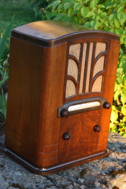

GE A-64 "Fish Mouth" with original finish / restored electronics.
I paid about that much for this one. It is not a bad radio, better than an A-63 but a far cry from it's big brother an A-82.
The curved top is cool. The "Fish Mouth" robot dial feature has never been popular. For this reason they are probably cheaper than round dial or slide-rule models.

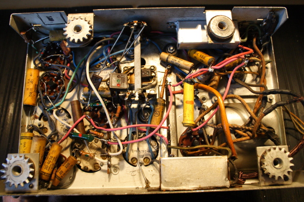

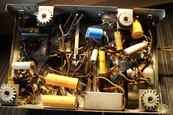

Looks like I replaced the rubber wire in the set pictured above.
Before:
After:
