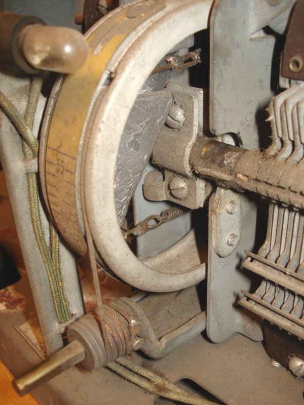

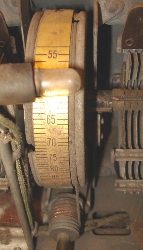

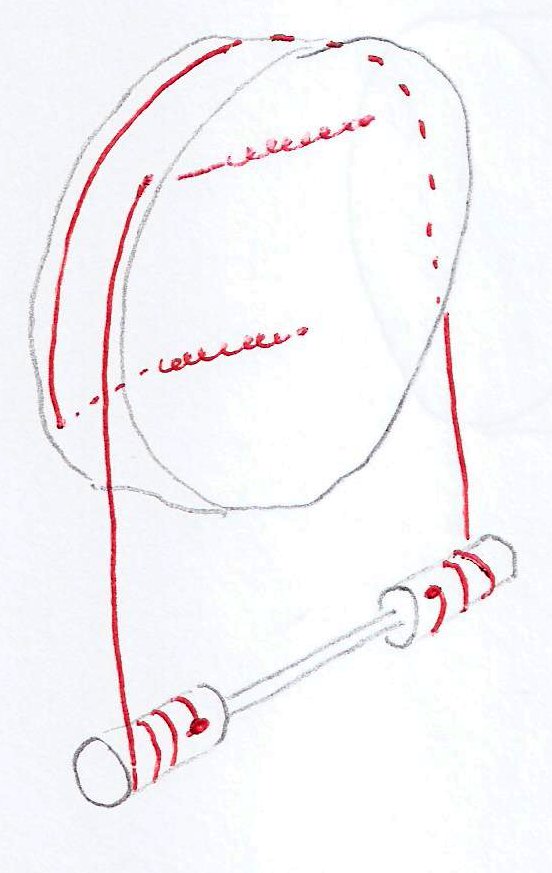

(10-11-2016, 02:57 PM)Kestas Wrote: I went and took a look at the chassis I have. The dial string is designed to pull from both sides. The setup is rotationally symmetric around a vertical axis. I couldn't take a picture of the setup on the back side. Here are pictures and a sketch to show what is going on.
The pics will be a big help. Thank you!

Great drawing! Maybe a moderator can put this in the tech section for future restringers.
