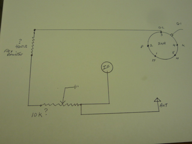

Here is a simple diagram of the volume ckt I have some unknowns
1. the 460ohm resistor the original was a flex resistor that was open. I found a section that had continuity and measured it then calculated that this is what it should be for the length, not sure if I'm right.
2 Vol pot was not original and was burned up I have used a 30k also with out any difference. Currently a 10k is this ok?
3 All the G2 pin 3 are tied in series
If I attach my ant to G1 of the 24A it plays great lots of stations.
What now?
Eric
Posts: 7,220
Threads: 266
City: Roslyn Pa
Hey Eric,
Methinks your vc circuit should be closer to this:
http://www.nostalgiaair.org/pagesbymodel...008952.pdf
A lot of the old TRF sets the vc on one end is tied the ant and the other the the cathode circuit of the rf amps, wiper is grounded.
How it works is as you turn the vc down it lessens to resistance from the ant to the chassis esscenually shorting the ant to ground. And at the same time it's also increasing the resistance of the rf amps cathodes to ground raising the cathode voltage higher which lowers the gain.
Conversely turning the vc up allows more signal to pass though the vc from the antenna and brings the cathodes in the rf amps closer to ground which increases the rf gain.
Repeat after me, no IF no IF no local oscillator no local oscillator.
GL my friend

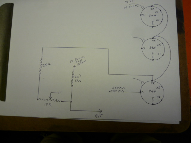

Ok I'm getting there but slowly I made a new print and hopefully corrected my mistakes
Posts: 7,220
Threads: 266
City: Roslyn Pa
Now that makes much more sense. As you move the wiper to the left the volume increases and to the right it decreases.
Your gettin' it!!!! If you follow the wire that goes to the tuning cap's bottom it goes to one side of the stator, the other side of the stator connects to grid cap of the 24A.

(10-06-2016, 05:22 PM)Radioroslyn Wrote: Now that makes much more sense. As you move the wiper to the left the volume increases and to the right it decreases.
So why do I get better reception if I connect the ant to the grid cap of the 24A than the ant terminal? I use about 25 ft of wire for the ant.
Thanks Eric
Posts: 7,220
Threads: 266
City: Roslyn Pa
Because you are connecting the signal after the volume control well sort of. The vc doesn't have a lot of impact on the ant side of things till it is at a pretty low resistance (shorting the signal to gnd) On the cathode side the vc has much more affect by varying the gain of the rf amp tubes.
So the vc doesn't do much till it's all the down affecting the signal coming from the ant but you are bypassing that part of the vc. The vc will work some because it still can control the rf amps gain though the cathodes. If there wasn't a connection from the vc to the ant when you turned the set all the way down you would still hear some signals. With it hooked to the ant it eliminates this situation
Clear as mud right???
