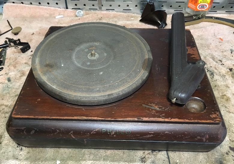

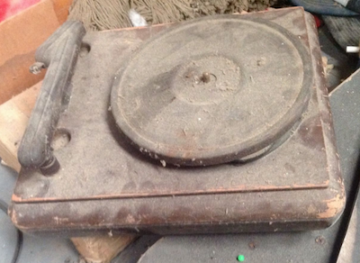

I purchased this off eBay last year and started restoring it. It then sat for 6 months when I got frustrated...

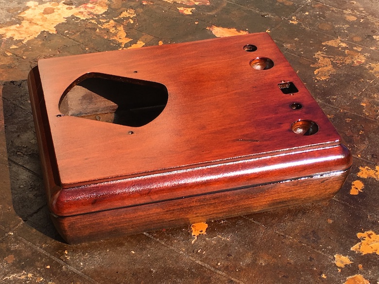

I stripped it and was trying to get the colors right but it was not working...
On the final coat of toner I slipped and got runs...

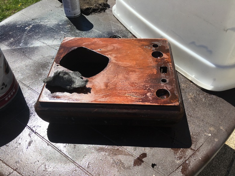

Today I decided to get it done.. I stripped it this morning but before I go and start toning. What do you guys think are the best colors?
 I had ex dk walnut on the bottom half and perfect brown on the top...
It just seemed too dark and to red...
It got dented and stuff while sitting in the workshop so I will have to try and iron out the dents...

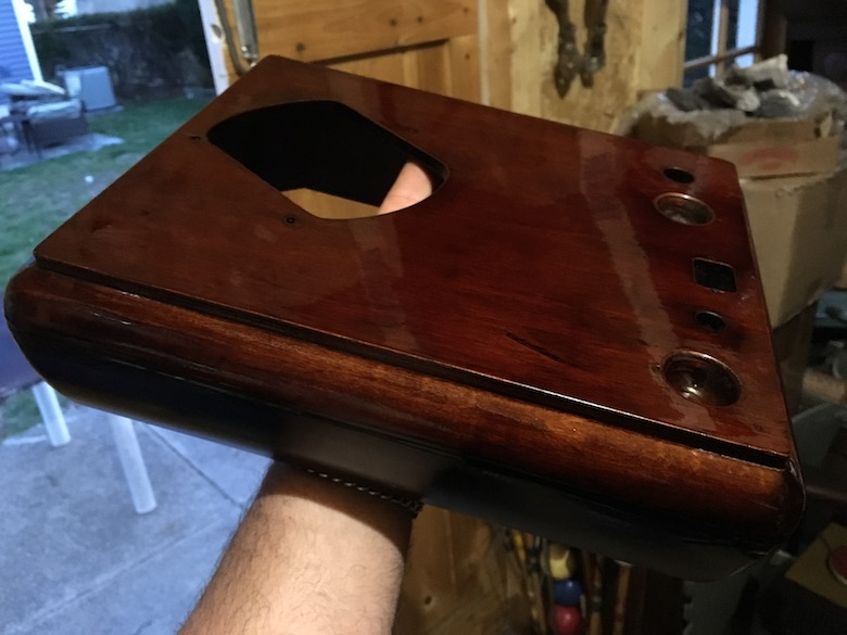

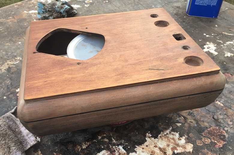

Here was the first attempt at color.

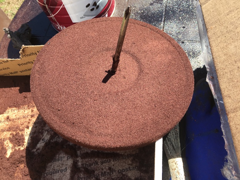

I flocked the platter too

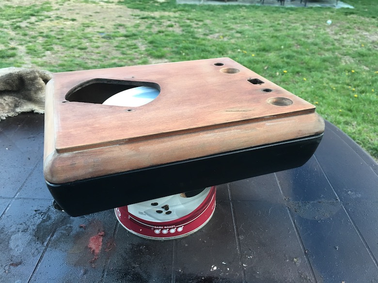

STrip IT!
This is where I am now...

My suggestions are (Ultra Classic, not Tone Finish):
Perfect Brown for the top part. Just enough darker than Medium Walnut that it should be a good match for the original, based on the picture in your first post in this thread.
For the sides...hmmm...that's another story. You need something darker than Perfect Brown but not as extreme as Extra Dark Walnut (which would be too dark). This is where I wish someone had experimented before me, but I'm not aware of anyone who has.
So...based on Mohawk's color chart...perhaps Dark Walnut, Dark Red Walnut, or Dark Walnut/Oak. Cans aren't that expensive...buy one can of all three, try them all on a piece of scrap wood and see which one matches best?
P.S. What was wrong with your first attempt? In the pictures, I thought the top part looked OK...as you know, you can always spray darker toners over lighter toners for the sides...You had mentioned runs. Were the runs in the sides, or on the top? If just the sides, then you could have sanded and tried, tried again...
I like to start over when mistakes are made. If I took some time to try and fix runs and uneven coating then sand through it by accident I would be really mad so I just strip and start over... I want it uniform and it was not.. I think I have the colors you mention but the 3015 walnut oak toner has red in it. I dont really see red in the original job. The 7020 walnut has no red...
I will just test them and strip if necessary.. Wood is forgiving...Thankfully, Icon_lol

After soliciting your advise via are last email I ignored it and I decided to strip it any way.
It was that seductive orange stuffs fault!!
Under the green there was white too. Ended up having the scraping the wht off
with a snap blade knife. Messy!!!

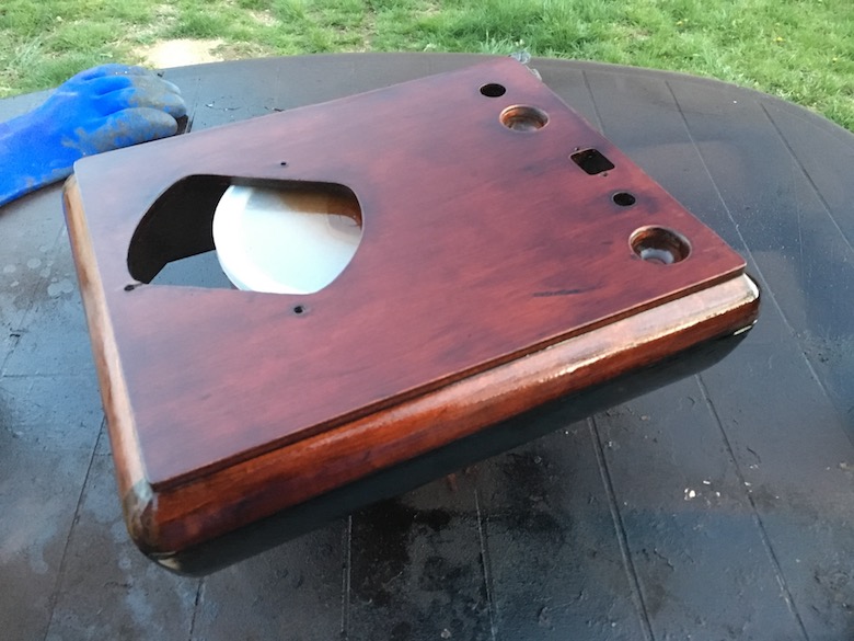

Toning..
5 coats of medium Walnut but not good enough and too red.. 5 coats of dark walnut did it for me...
Picture is 3 coats of Dark walnut.. I added 2 more after pic.. Tomorrow I will tape off the top and tone the ex dk base..
