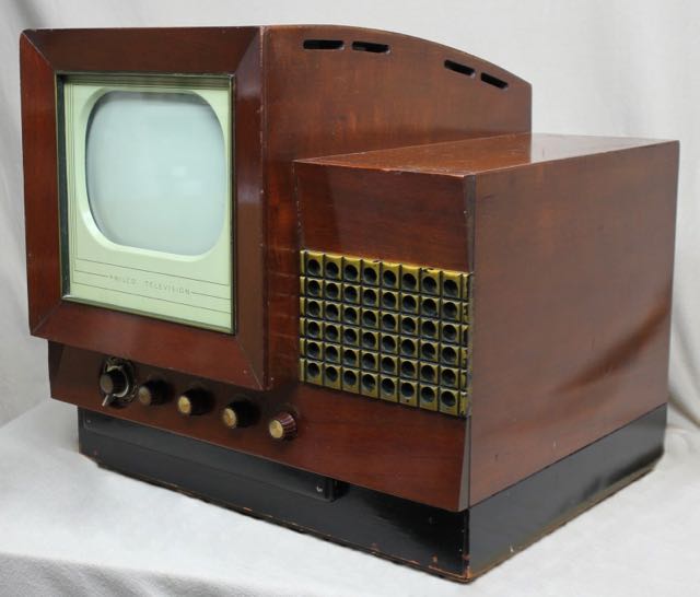

back into this:

 No stain, toned or tinted lacquer was used, if the bottom was black, and not extra dark walnut tone spary, then black lacquer paint will be fine. I should point out something though, there is tinted lacquer and there is toner, tinted lacquer is what you want on the veneer and that frame around the picture tube, toner is more opaque. Before any of that goes on the grain will need to be filled with a filler, especially if it is mahogany which is very open grained, although you would still need to do so with walnut veneer as well. The original finish was top coated with gloss lacquer that was then rubbed out after being allowed to cure for a certain length of time. I don't know what species of veneer these sets used but it does look like a mahogany, scape the finish off one of the old pieces and wet it to see what the grain and colour is like, if in doubt photograph it and post it here.

 It may have been brown rather then red mahogany, if the cabinet was mahogany to start with. I have a 1949-50 G.E TV which I think used some form of mahogany, which was finished in a similar way to the Philco in the lower picture, but the only exposed wood, with no finish, is on the top which has something sitting on it at the moment. If it's a mahogany it's plain cut, it isn't ribbon mahogany with the alternating dark and light stripes.

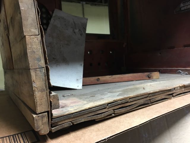

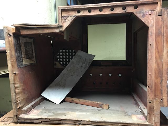

  In looking at the above picture of your 48-1000 it looks like it was badly water damaged which means that it will probably have to be dismantled and some of the cabinet parts will have to be replaced. Maybe you will be lucky enough to be able to glue the delaminated layers back together, and flatten them out, but if not see if you can get some help from someone with a lot of cabinet or furniture making experience. Baltic birch seems to be a good material for radio and early TV cabinet construction, it's made up of thin layers of birch veneer and the overall thicknesses seem to be very close to the hardwood plywoods they used to use, like 1/4'' is 1/4'' and so on, not something like 7/32''.

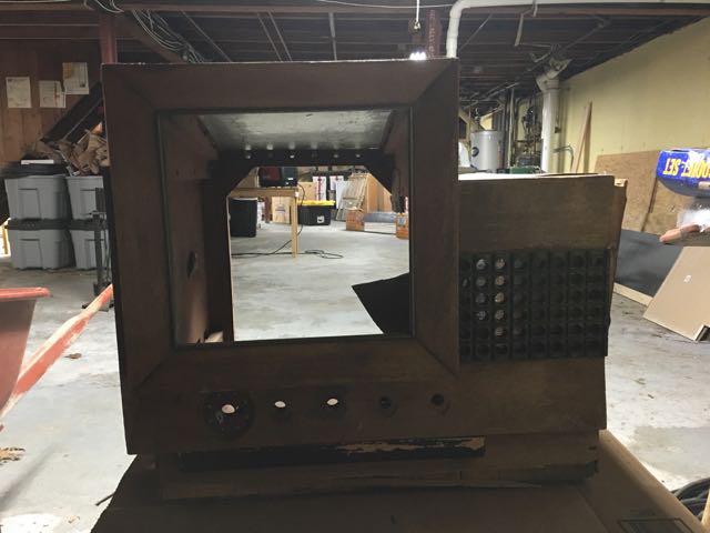

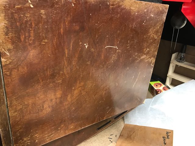

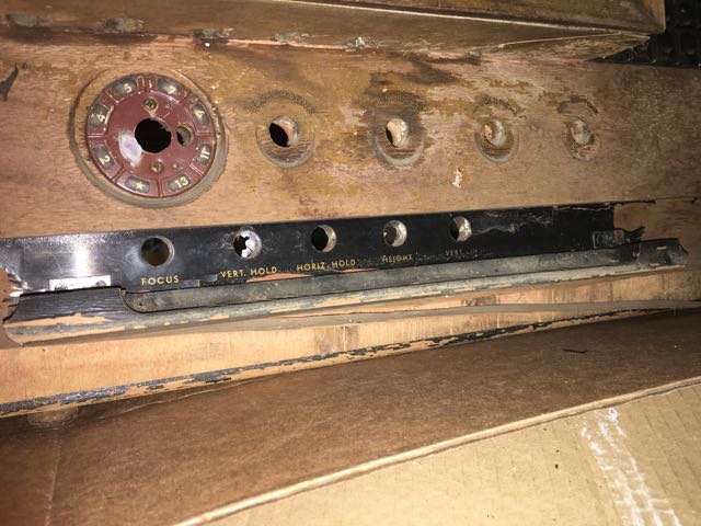

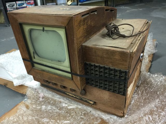

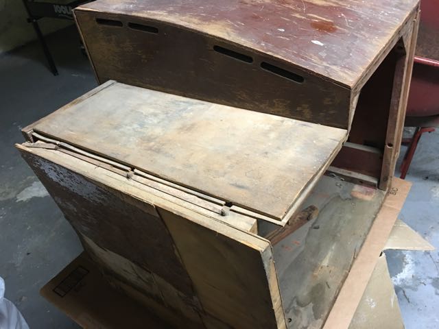

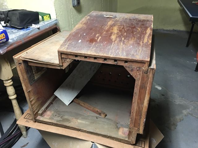

Here are some "before" pictures of the cabinet.  It was on my aunt's garage floor in Los Angeles for over 40 years.  It is now in my basement in Massachusetts where I'm working on it.
One more before pic (is there a limit of 5 attachments?  I couldn't add this to the previous post.)

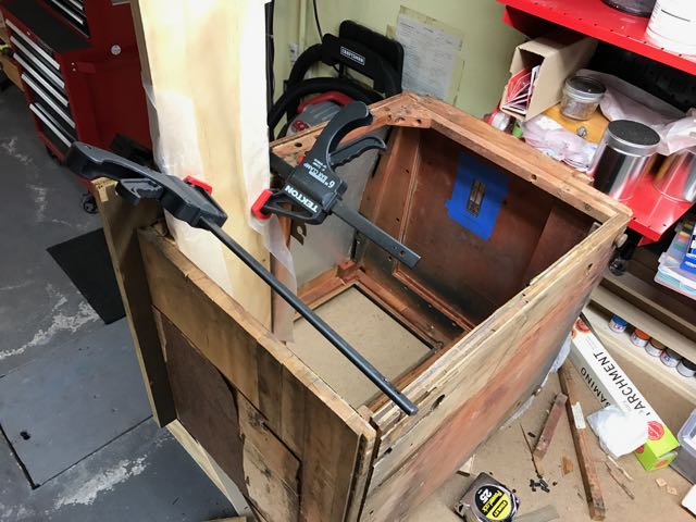

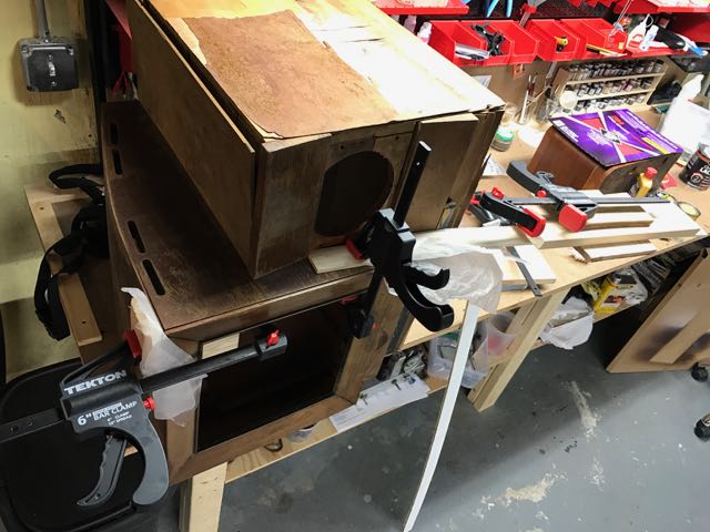

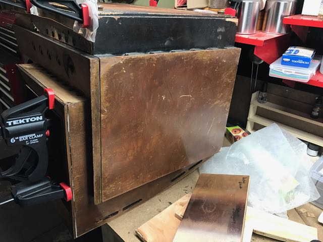

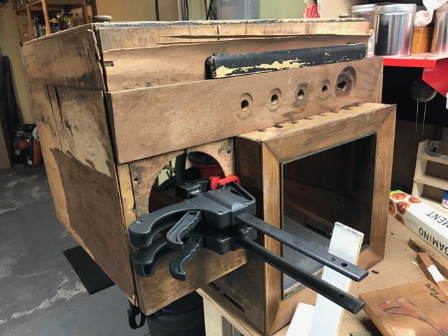

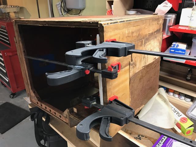

I have been "relaminating" the water-damaged wood.  I inject wood glue and then clamp overnight.  I also have some wood hardener that I may put on some of it.  Once the wood panels are solid I will fill the stripped screw holes with putty/woodbits/glue or some such and re-drill/screw them.  At that point it should have its structural integrity back.  After that it's veneer and finishing.  In the first and last pictures below you can see how the bottom panel is glued together now and intact, compared to the before photos above.

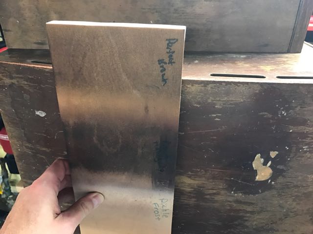

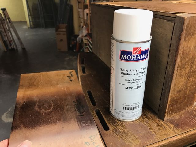

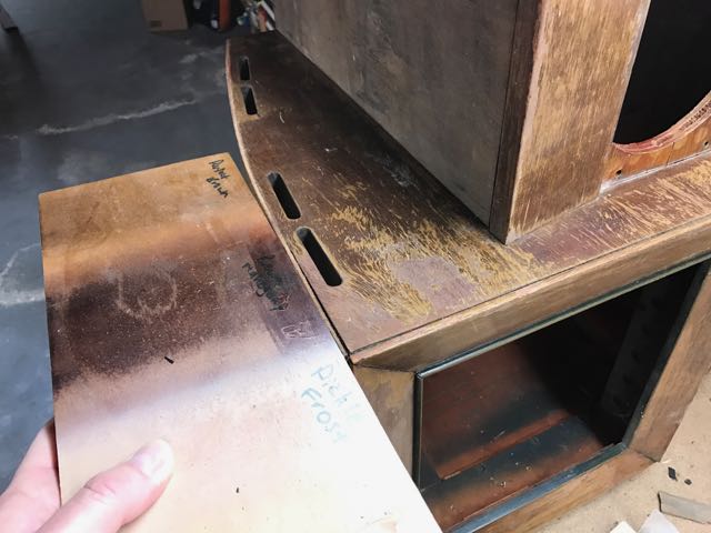

I'm thinking of Mohawk brown mahogany (the middle color on my test board), perhaps with some clear/amber lacquer over that. The pictures I have of it, like the reference pic in the post above, show a redish/orangish finish. I think the brown mahogany/amber combo would get close. Do you think that would replicate the original finish color?

- Mohawk brown mahogany toned lacquer
- Amber lacquer over that

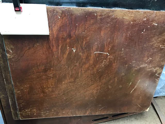

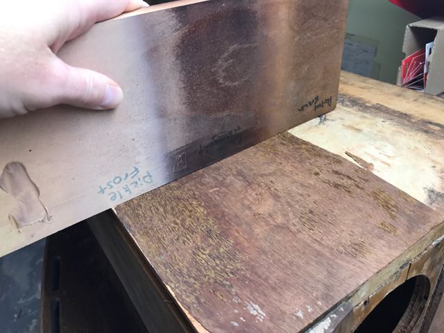

Here is a good view of the wood grain and finish (what's left of it) on the one good side of the cabinet.  Does it look like Mahogany?  I my brown mahogany toned lacquer + amber lacquer plan a likely match?
 Yes, I think it is a mahogany, I'm not sure what cut it is on that side though, crotch maybe? The other stuff looks like it's plain cut rather then quarter cut. It's not a walnut though, but I'm also not sure which species of mahogany it is, Honduras possibly, Brazilian maybe. Look up the various species of mahogany and see which one is closest, Constantine's used to have a gallery of different woods, if they don't someone else will. You might need to pick up some maple veneer for a underlying layer for parts of the cabinet as I can see that it's missing from some spots, the grain normally runs in the opposite direction of whatever is on top.

I am getting different answers from different people on the final, top-layer, 1/32 veneer. Some swear it is mahogany, some swear that it is walnut, burled maybe.
How can I be absolutely sure? Who, or what resource, could I consult?
