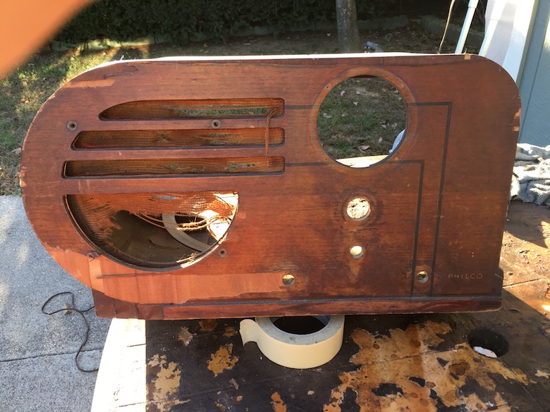

Front:
[Image: http://www.philcoradio.com/images/phorum/37610_004.jpg]
Some deep faults in the upper right corner of the front panel were filled with wood filler. Later, I will attempt to touch up the light areas with some Medium Walnut toner - but only after the cabinet has been stripped, sealed, and grain filled.

After stripping:
[Image: http://www.philcoradio.com/images/phorum/37610_006.jpg]
Not bad...but stripping the finish in combination with the bright sunshine revealed...more flaws!
