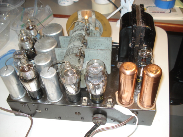

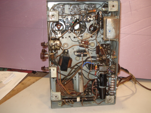

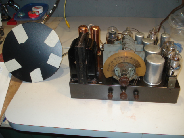

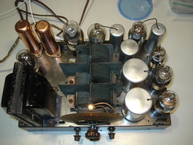

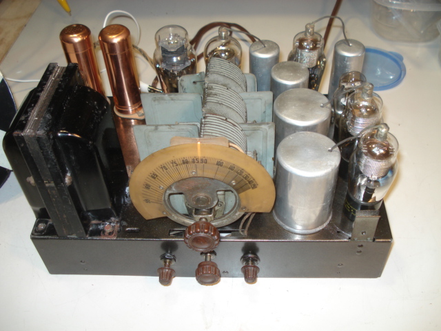

Hi guy's and Merry Christmas......had a good Christmas, got the Philco 70 up and running after a recap and rewound the RF Coil did some cleaning and painting on the chassis.
The alignment schematic shows three adjustments on the back of chassis but this one has only two. According to the tube configuration this is the early model below B22,000? I can find only one alignment procedure, is there another one. I do have document's from the Chuck at the Philco Repair Bench.
Also the volume seems a little down on distance station's the strong local stations are fine.
I want to thank all you guy's on this forum and the one's that responded to my post's
Here are some pic's. Do have some work on the cabinet, but I'm over the hump as they say.
Jim
Spring Lake MI

Could it be that you missed the one that has a metal cover over it? It is all the way to the left side of the chassis. This one is covered because, the trimmer has B+ voltage on it.

(12-25-2016, 01:12 PM)Steve Davis Wrote: Could it be that you missed the one that has a metal cover over it? It is all the way to the left side of the chassis. This one is covered because, the trimmer has B+ voltage on it.
Wow am I losing it thank you so much...........
