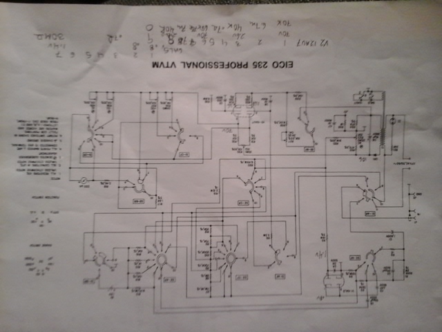

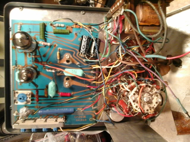

Just have some time to repair. I almost gave up could not find the schematic. Once  I did the two main problems zero adj R23 bad. R6 3.3M leaky. I again replaced all carbons. I did not have a 91M so the mass on the upper left is 20M and one 10M. I replaced the cap and diode as well.

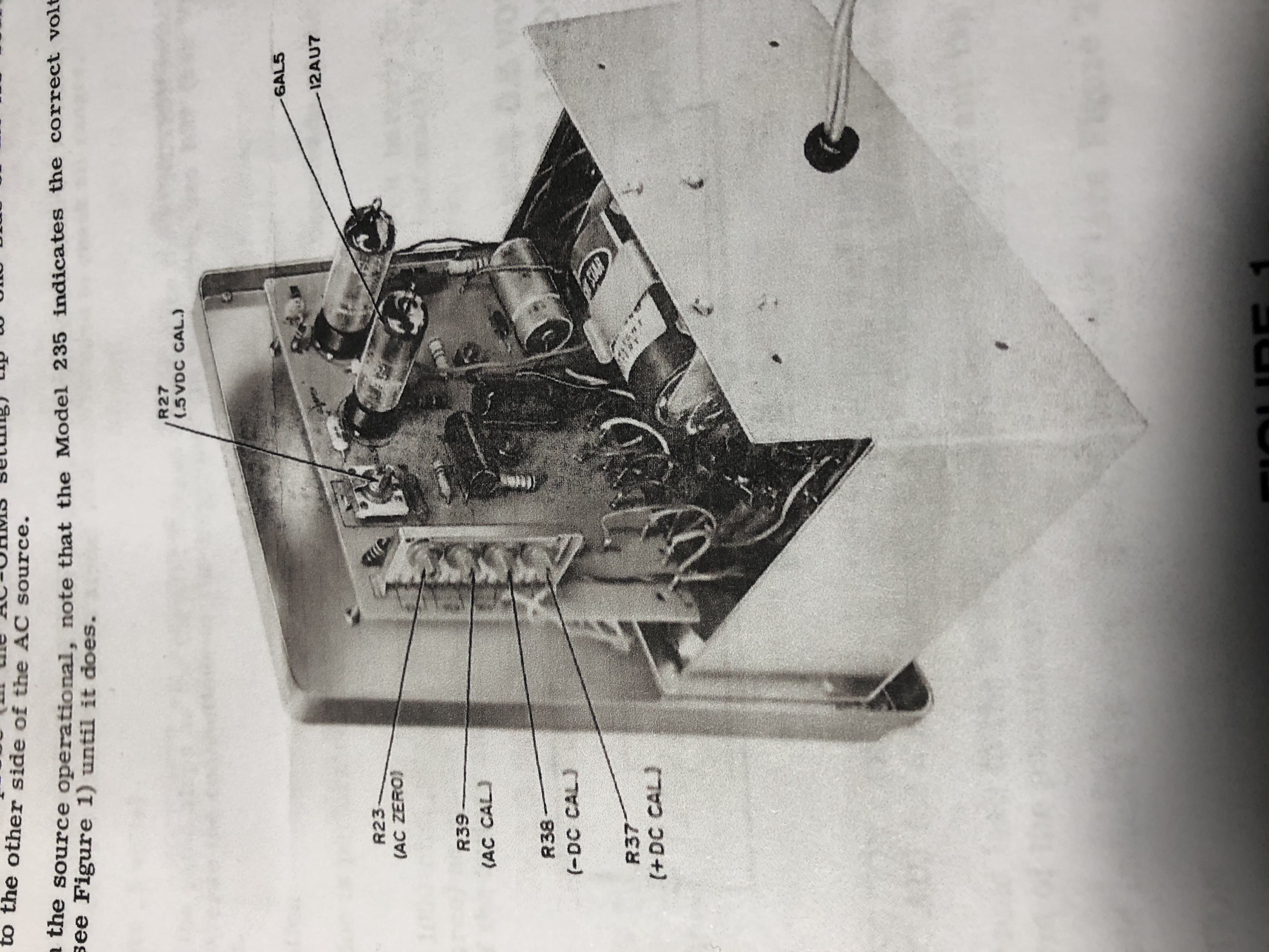

Here is the page in the manual that helped
The schematics
Hi, I am looking for some help on the R-23 when I try to do the calibration it says to adjust R-23 to zero the meter but R-23 does nothing. Where did you get with yours?
