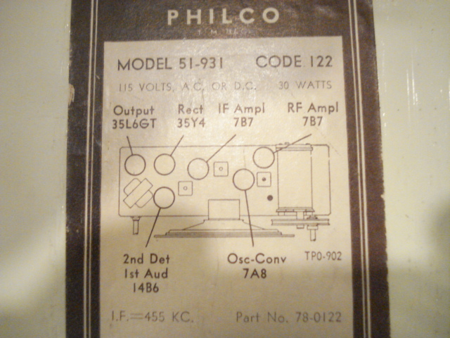

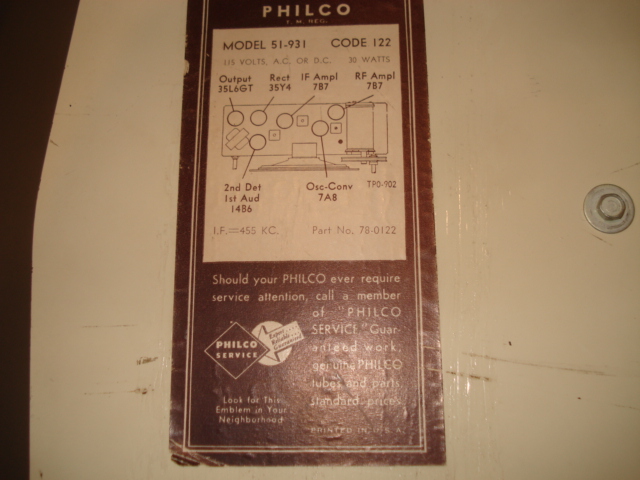

Hi guy's, Restoring a Philco 51-931 code 122, the Rider schematic shows a 35Z5GT as the rectifier but this radio has a 35Y4 loctal tube. It should not be an issue for restoration, just thought it was a little odd.

Guy's, after posting this thread I noticed that this radio also has a 50L6 instead of the 35L6 which the schematic shows. It looks as thought this is an original tube.

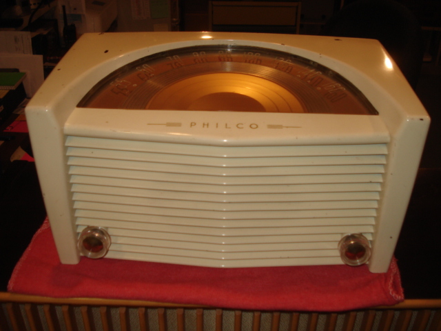

Just thought I would show the radio in question, it is completed.
