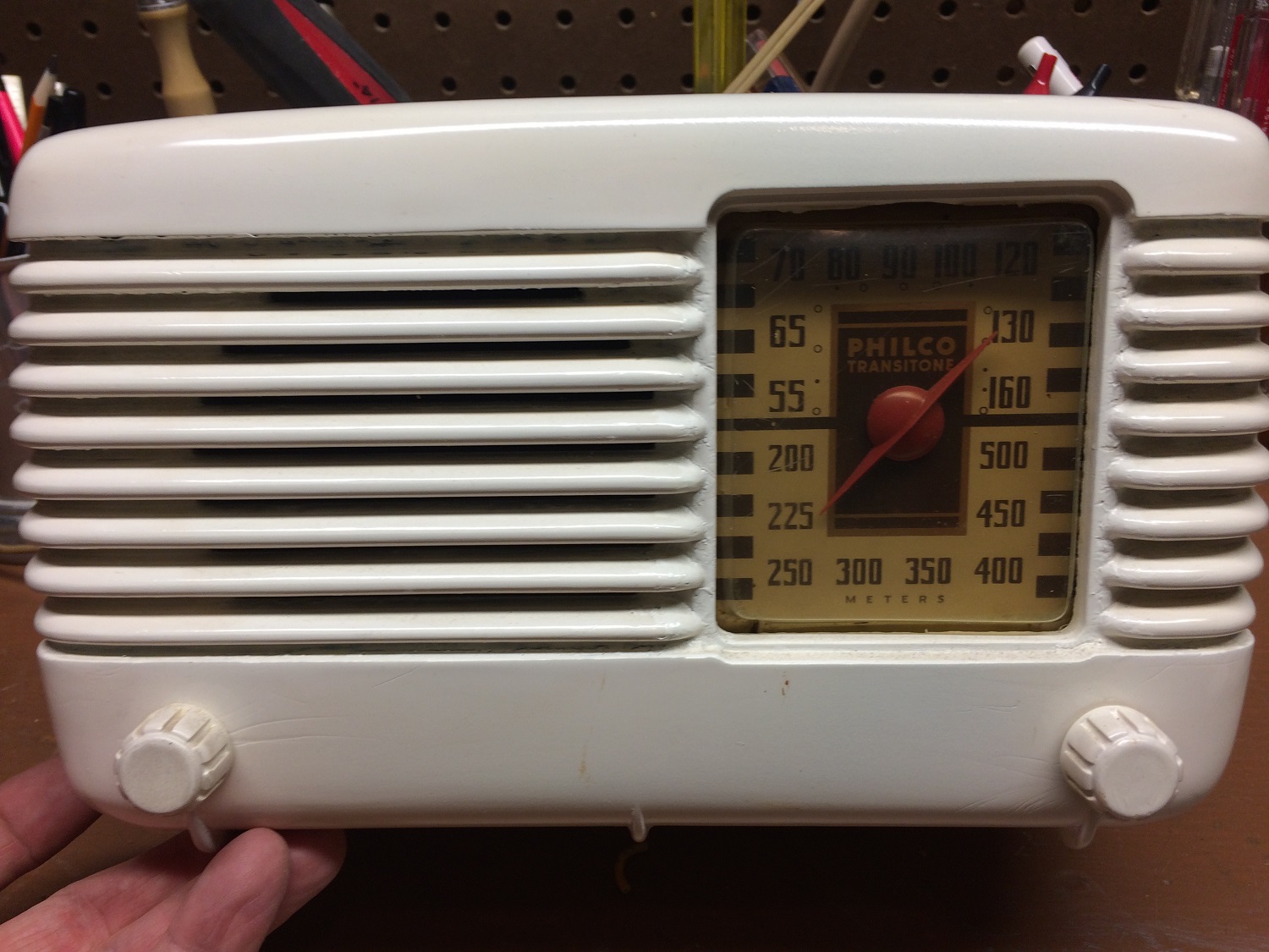

Hi all- I started in on this little thing tonight.  It is a spray painted (white) little 42-PT91 that was given to me a while back.   I'll post a couple pictures tomorrow...but a couple questions:
How to strip this cabinet?  The cabinet, itself, is in good shape, but the paint looks like crap.  I did a little research a while back and think I saw that oven cleaner works?..
The plastic dial cover is yellow and scratched up....first, how do you get those clips out? I'm nervous about busting the bakelite...even if I keep this old plastic, I need to get it out to strip the cabinet....
And it seems the knobs were not original and are solid white...so I'll be needing some brown ones, I guess...

Don't use oven cleaner, it might damage the Bakelite, use paint and varnish remover, or if you have a large quantity of it sitting around DOT 3 brake fluid will also strip it off but take longer. The lens is probably held in with tri clips, they are circular shaped with three fingers that snap into holes on the inside of the cabinet, they will pop out by slipping a thin flat bladed screwdriver under them. These cabinets came in both brown Bakelite and ivory painted versions, if the original paint was chipped that may explain the crappy repaint.
Oven cleaner is going to make it real dull but wont hurt it. I dont recommend it.. Plus it melts plumbers putty as I found out while stripping some knobs in the sink, Icon_lol

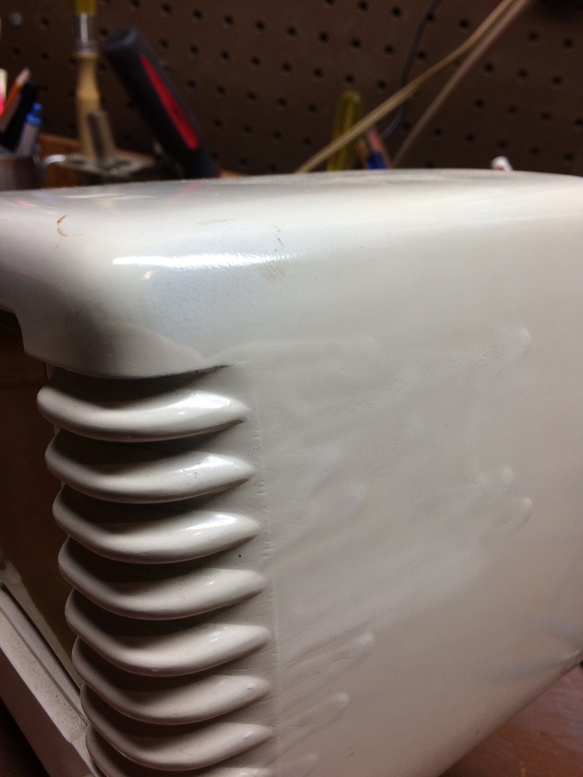

Thanks for the tips.  I would bet this one was brown, originally. But I'm not 100% sure.  Like I said, I'll share some pictures after work, but on one of the sides of the cabinet there are multiple large runs, but then there is an area around the top corner (same side) that the paint is so thin you can see the brown underneath.  The knobs have me scratching my head, though.  If it is factory paint, will it strip off ok?

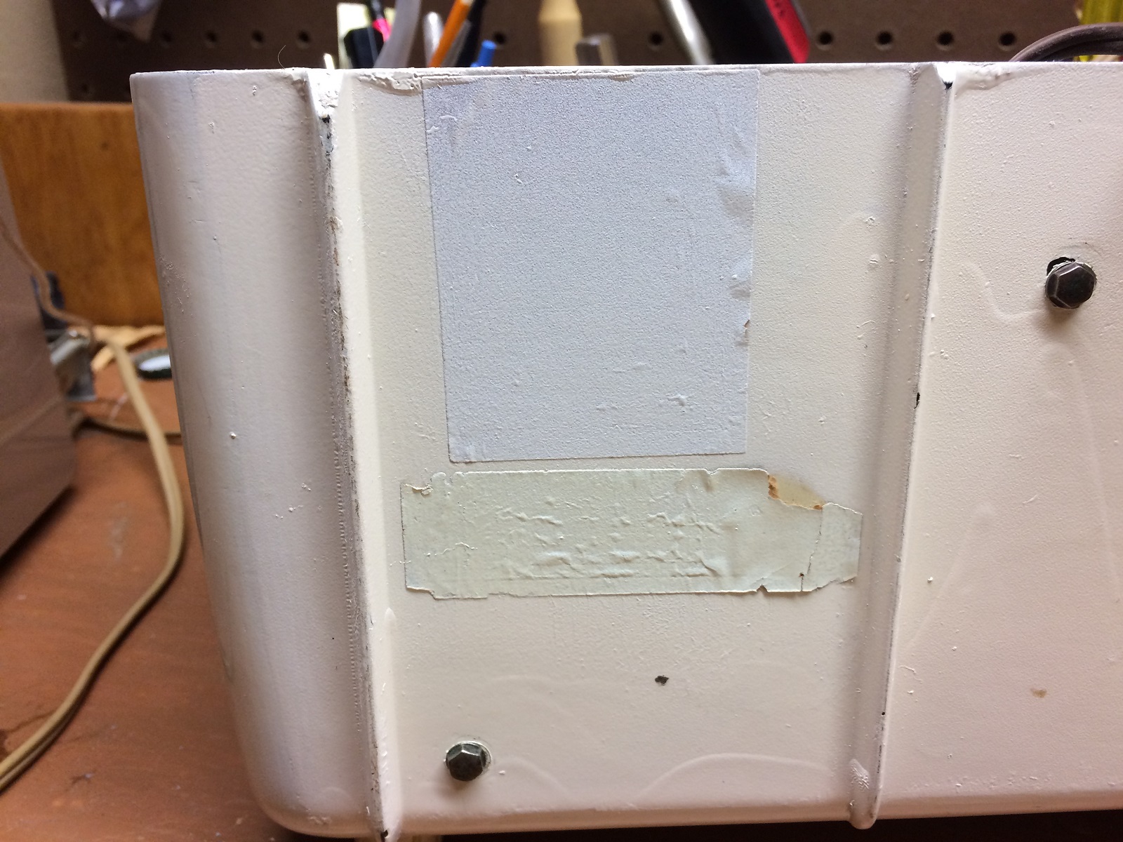

The labels on the bottom are painted over....
Huh...they seem to be solid white plastic?, no paint.  And look different than the radio museum pic I saw.   So do you think this one was originally white? And somebody did a crappy repaint?   I guess it doesn't matter much, I think I want it stripped...as long as it will come off ok....and I can find some brown knobs..

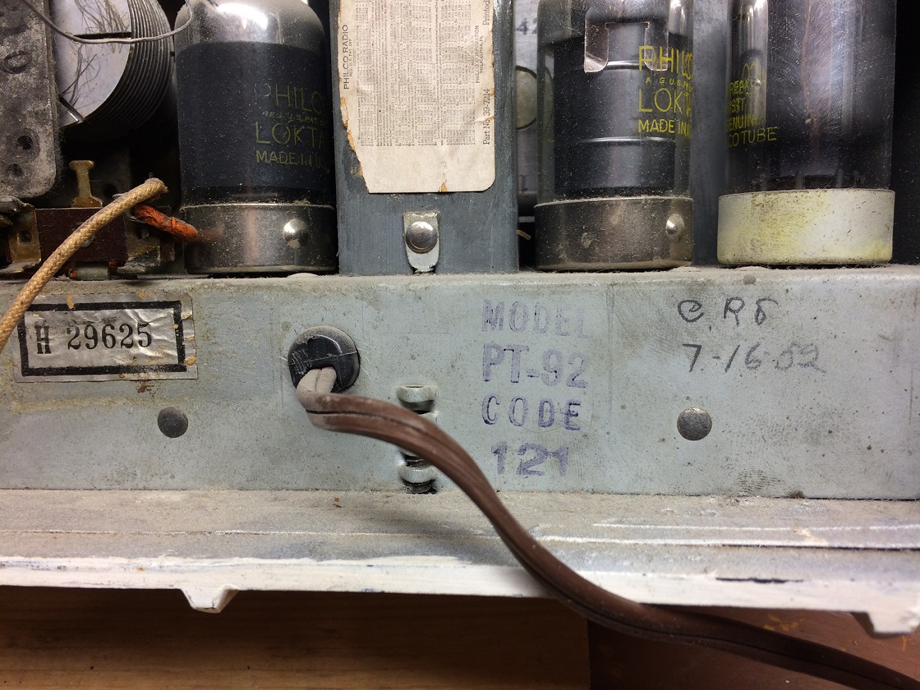

Great info, thanks guys.  I did snap a shot of the stamp on the chassis and this thing was originally white (or ivory)!  I'll go down and check the inside of it in a bit...I really would rather have a brown one, so I'm gonna strip it and leave it, as long as there are no repairs to hide.  Icon_smile  I'll need some original brown knobs, though......Thanks again for the info!

Ya never know how it wound up like that, maybe  a kid had it and was trying to redo it. The drips marks are rough though.
