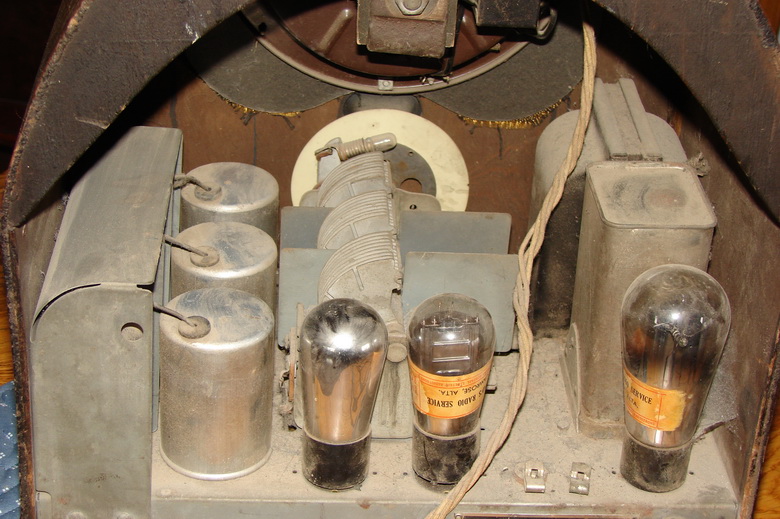

Nice find Dan, don't see to many Canadian models for sale. Don't use electrolytic's in the filter can, use 630 volt poly caps.

Hey Dan,
Just push in your 71A and you'll be good to go[Image: http://philcoradio.com/phorum/images/smi...on_lol.gif]
On model 20's pull the spkr plug and measure resistance against each other. All pin should have a max of about 7,000 ohm or less.
Check the primary and secondary of the rf coils and audio driver transformer. RF coil less than 10 ohms audio trans less than 2,000 ohms.

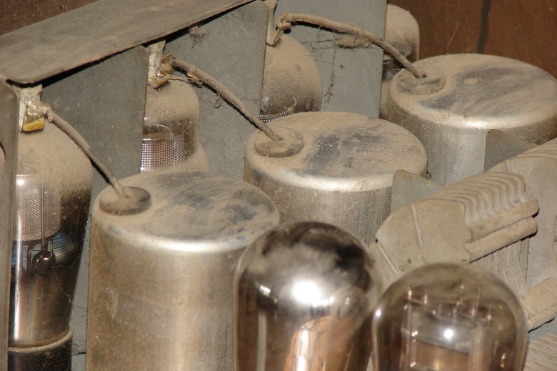

To me the nastiest part of restoring the 20 is emptying that capacitor array can. It is truly messy operation. Somehow a similar can in 16 emptied just fine, a can in 111 was a walk in the park, but this one.......nah-stee.

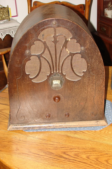

The open RF coil problem seems to be more common on some models then others, but it doesn't mean that this set has that problem, it does however have the obligatory broken speaker grille. I was trying to remember which issue you had with the speaker in one of your sets, I thought it was either a field coil or an output transformer, you actually encountered both but in different sets. It's not difficult to test either the field coil or the output transformer, and it isn't always an issue. I would think that the output transformer would be a more common point of failure then a field coil, but you never know if or when someone might have tried plugging the set in and BBQing the speaker field so it's worth knowing before you start.
As for the condenser can, this is where a second hand toaster oven comes in handy, the model 16 and 111 must have had their cans lined with fish paper if they pulled out easily, I cleaned out a can in a Westinghouse and had to resort to driving a large screw into one of the paper caps to pull the guts out as it wasn't lined.
