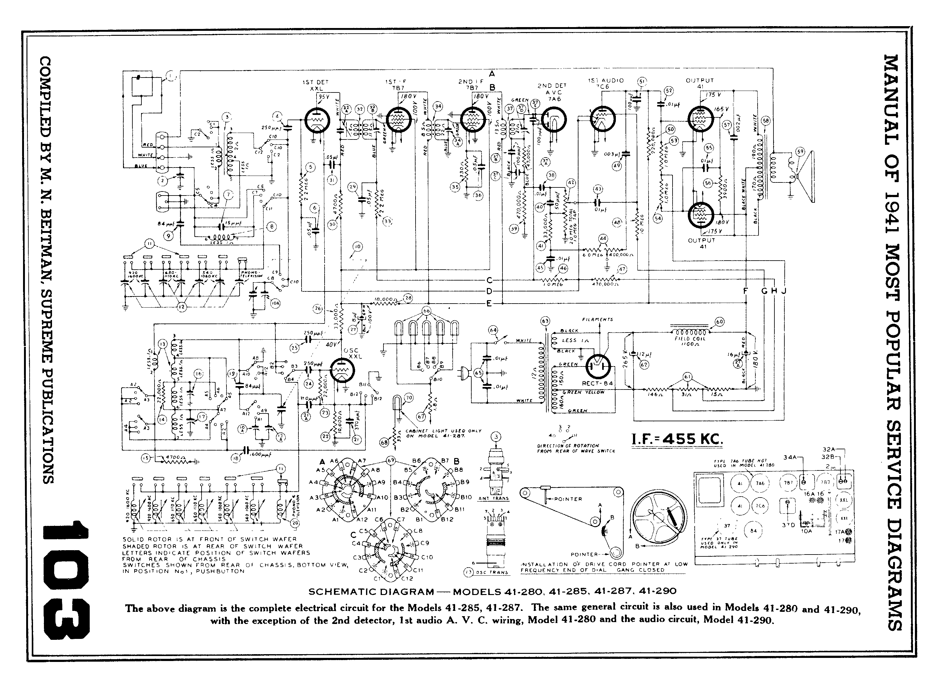

Lee, Hope this helpful. David
Thanks very much, David ,  I knew of Beitman / Supreme manuals ( maybe a few around the house ) , that was exactly what I was  looking for, with my post !  Are they listed , like Riders on Nostalgiaair , somewhere on the internet ?

David ,  I found the "on line version of the Beitman / Supreme manuals " ,  I always thought , those small books were the inexpensive version on the Riders manuals , and weren't nearly as complete , I was wrong !
