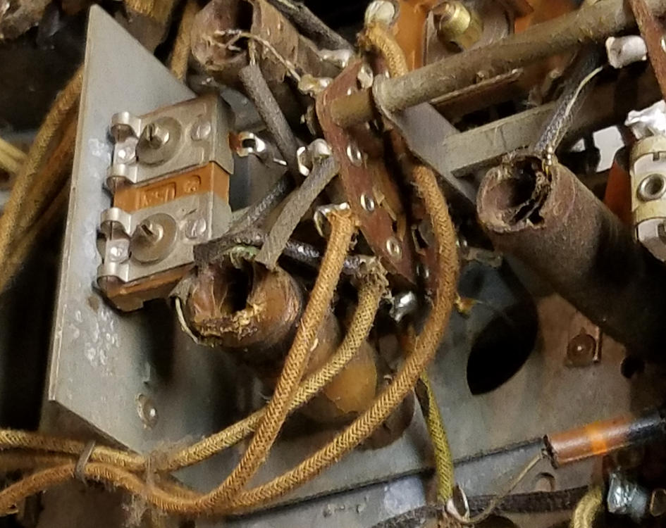

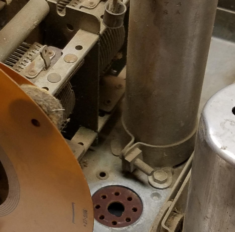

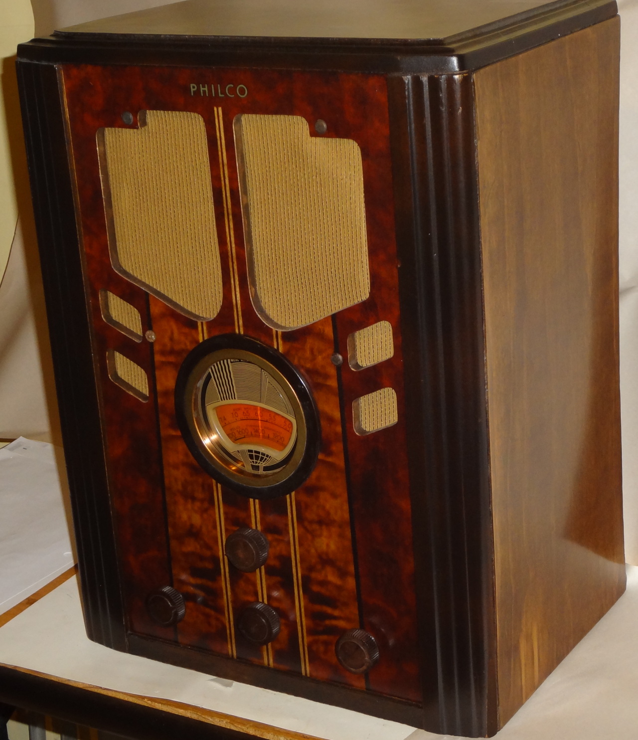

Terry,
Here are 3 images.
In the first (38_60_Ant_Coil_1), the BC antenna coil is the lower right coil form of the four. The front of the chassis is toward the top of the image.
The second image (38_60_Ant_Coil_2) is from the side, the BC coil is in the lower left. The front of the chassis is toward the right side of the image.
The third image (38_60_top_side) shows the top of the chassis. The BC antenna is to the left of the big cap can, beneath the tuning cap assembly. I don't see any screws underneath the tuning cap.
From images 1 and 2, it looks like there is a whole assembly with a right-angled bend that is mounted beneath the chassis. Maybe there is a screw coming from the top side of that?

Posts: 7,323
Threads: 270
City: Roslyn Pa
Not seeing what I was thinking of. I'd put a 100mmfd cap across the top of the pri over to top of the secondary and be done w/it.
Posts: 670
Threads: 11
Joined: Sep 2014
City: Bellmawr, NJ
looks like it attached to that flooding chassis,,of the tuner,,I see screws to that tuning chassis is separate ,,in Pic 1,,,WOW
Posts: 395
Threads: 33
Joined: Jul 2013
City: Horsham, PA
I looked at it again, it seems like the coil forms attach to a "band switch sub-sub-chassis" which is attached to the RF sub-chassis. Modular design gone haywire
I guess I'll start by pulling the RF deck and take it from there. Maybe when I get that out I'll be able to see how these coil forms attach. I would prefer to rewind the coil if possible. I'll keep the idea of using a cap to shunt across the windings in my back pocket.

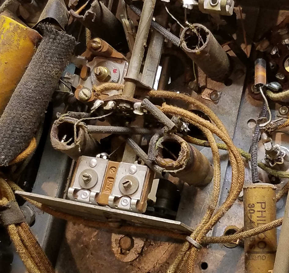

I finally finished this set a couple of days ago. I needed to:
1) Get the speaker re-coned.
2) Install new veneer on the top. First time for me.
3) Perform some rather significant cabinet repairs, as the cabinet itself and various parts of the veneer were literally coming unglued.
4) Replace the open antenna transformer. I decided to buy a replacement from AES. Seems to work great.
5) Install a new photo finish on the front. First time for me.
6) Recap and re-carbon as usual.
This was probably the most difficult restore I've done so far. At times it really challenged my patience. I actually had to remove the RF sub-chassis twice because of a boneheaded move I made  The mounting bracket for the shortwave antenna coil had broken at some point in the past, so I fashioned a new way to mount it. What I didn't realize until I had it all back together and tried aligning the SW band, was that my mounting bracket actually shorted out the SW antenna coil. I never even looked to see if that might be happening! In order to undo what I had done, I had to take it ALL...BACK...APART...ugggghhhh!!!
Thankfully, that is all in my rear view mirror now and overall, I am happy with the result. It receives great on both bands. Here are a couple of photos
A big thank you for everyone's input throughout.
Jon
