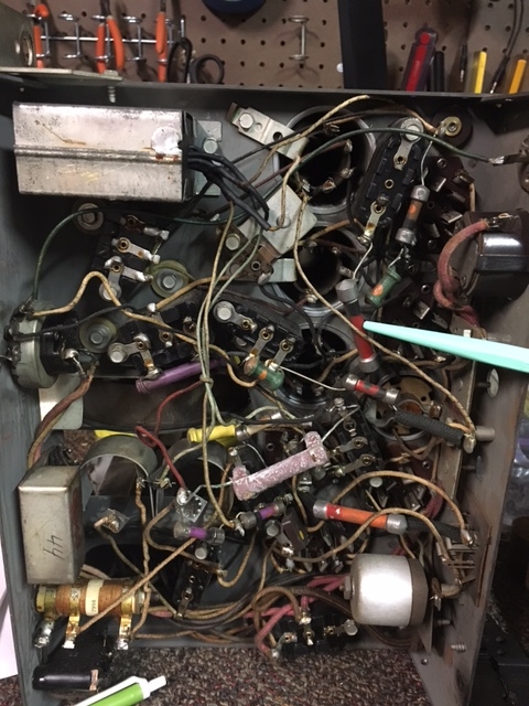

First.   In chassis picture 1.  There is a resistor (violet,green,red) hooked up between lug 6 and 8 of the condenser block labeled part 8.   Though there is a resistor labeled as being here on the schematic, the value is waaay off and it is not noted as being a larger 1 watt type.

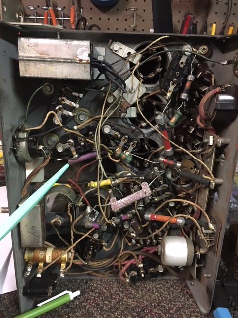

Second.  In chassis picture 2.  There is what appears to be an aftermarket add on.   Though there is a resistor here in later schematic versions, code 122 does not show this part.  It is hooked up between the positive terminal of the electrolytic to the unused lug of condenser block 27.   This resistor is valued at 2.1K and essentially cuts across the coil of the shadow meter.....which has a value of 1400 ohms. But has 2000 written in pencil on it.   (perhaps the coil went open at one time and this was put in?)

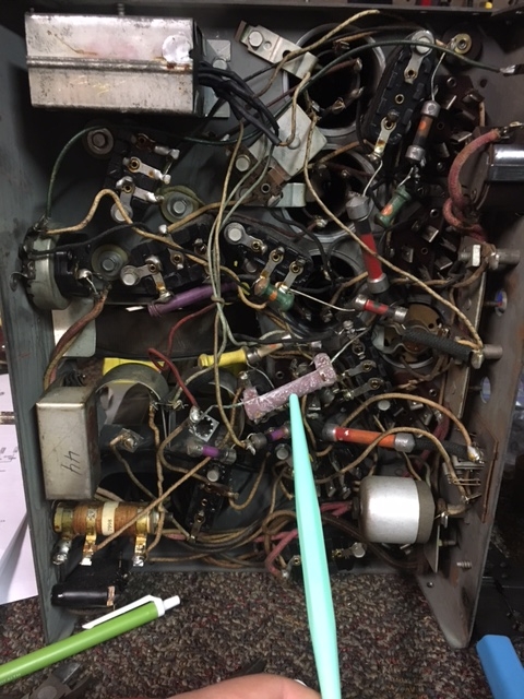

Third.  In chassis picture 3.  Is what appears to be an original 1 watt resistor (red, black, red). connected to the end of the newly added .05 mfd condenser block (added for code 122 chassis and shown on schematic below).  However instead of it running to part 8 condenser block, it is mounted to the end of the aftermarket resistor on the unused lug along with one leg of the shadow meter coil.

The resistor connected to capacitor block 8, is the cathode resistor for the oscillator. Philco originally  used a 15K but, it is recommended to go down to a 10K or even 7500 ohm for reliable oscillator operation.
