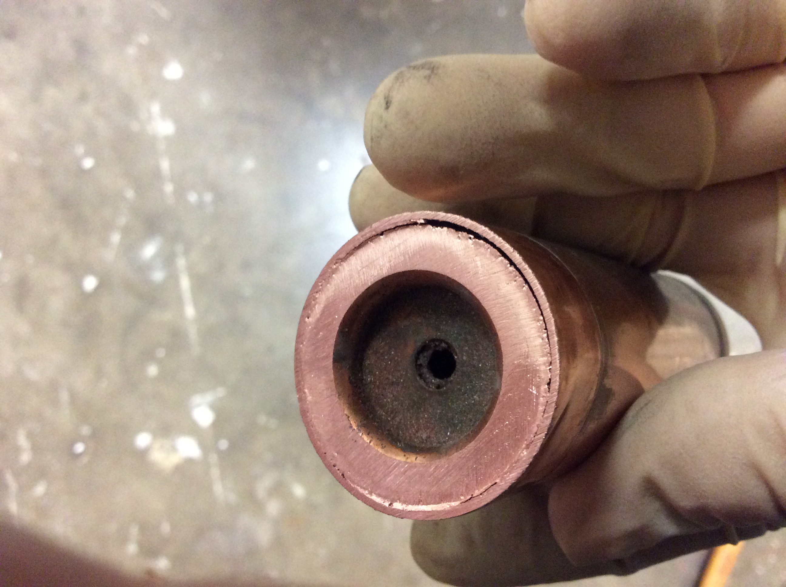

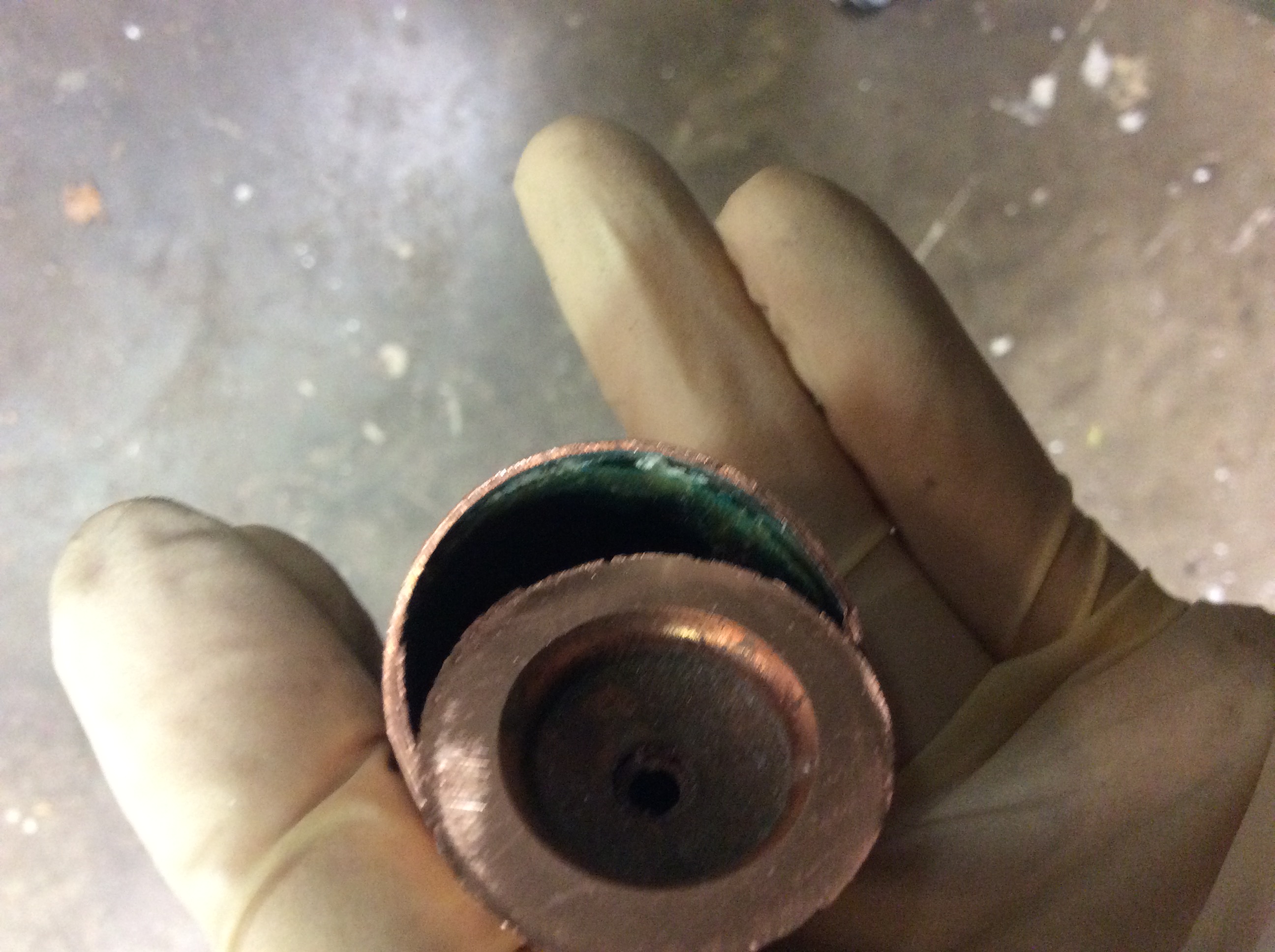

To remove the caps, I froze the can for a few days.
Then I immersed the top cap in boiling water.  Used a pair of rubber gloves wrapped around the cap with a set of channel locks for a grip.
GENTLY twist them off. They came off very easy.

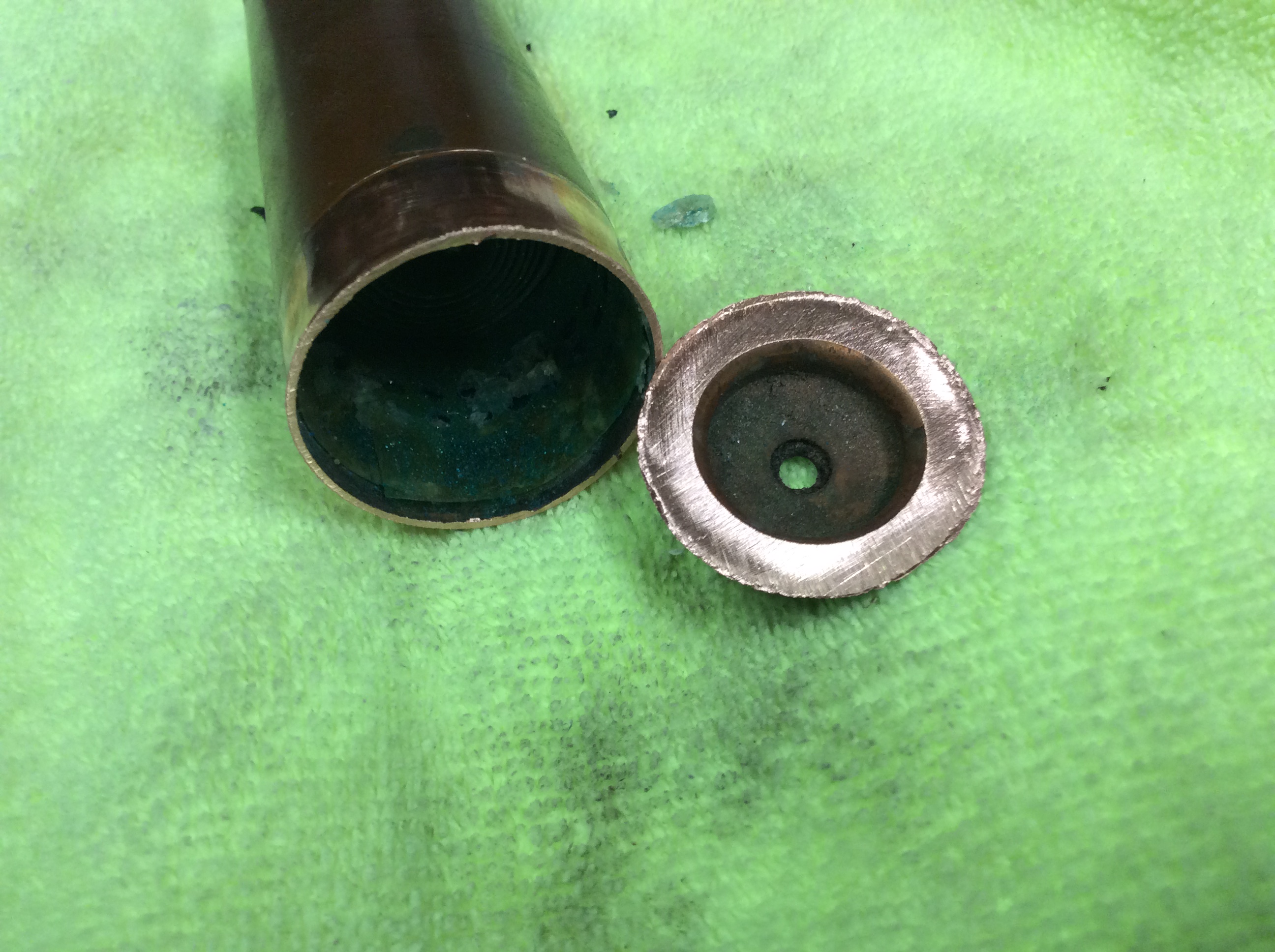

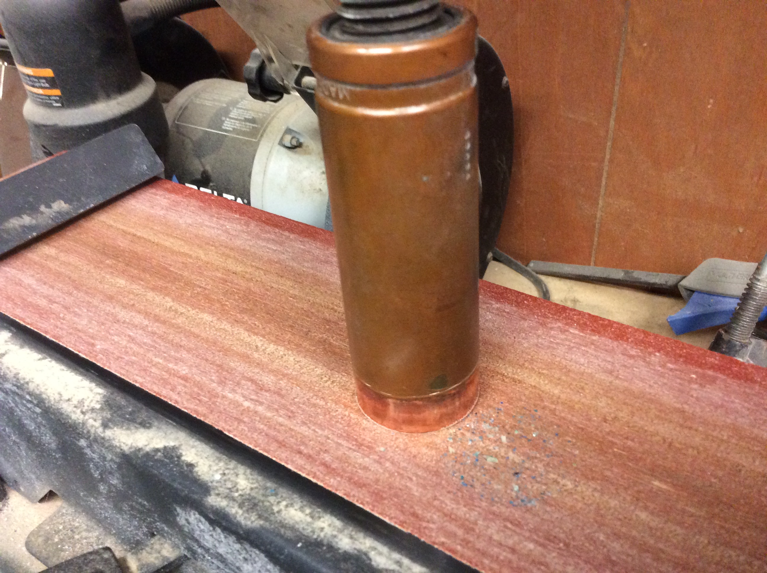

Next, I thought of a neat way to get at the insides.
Invert the can on a stationary belt sander and sand lightly.
Took less than 2 minutes.
No digging, drilling, cutting etc.
