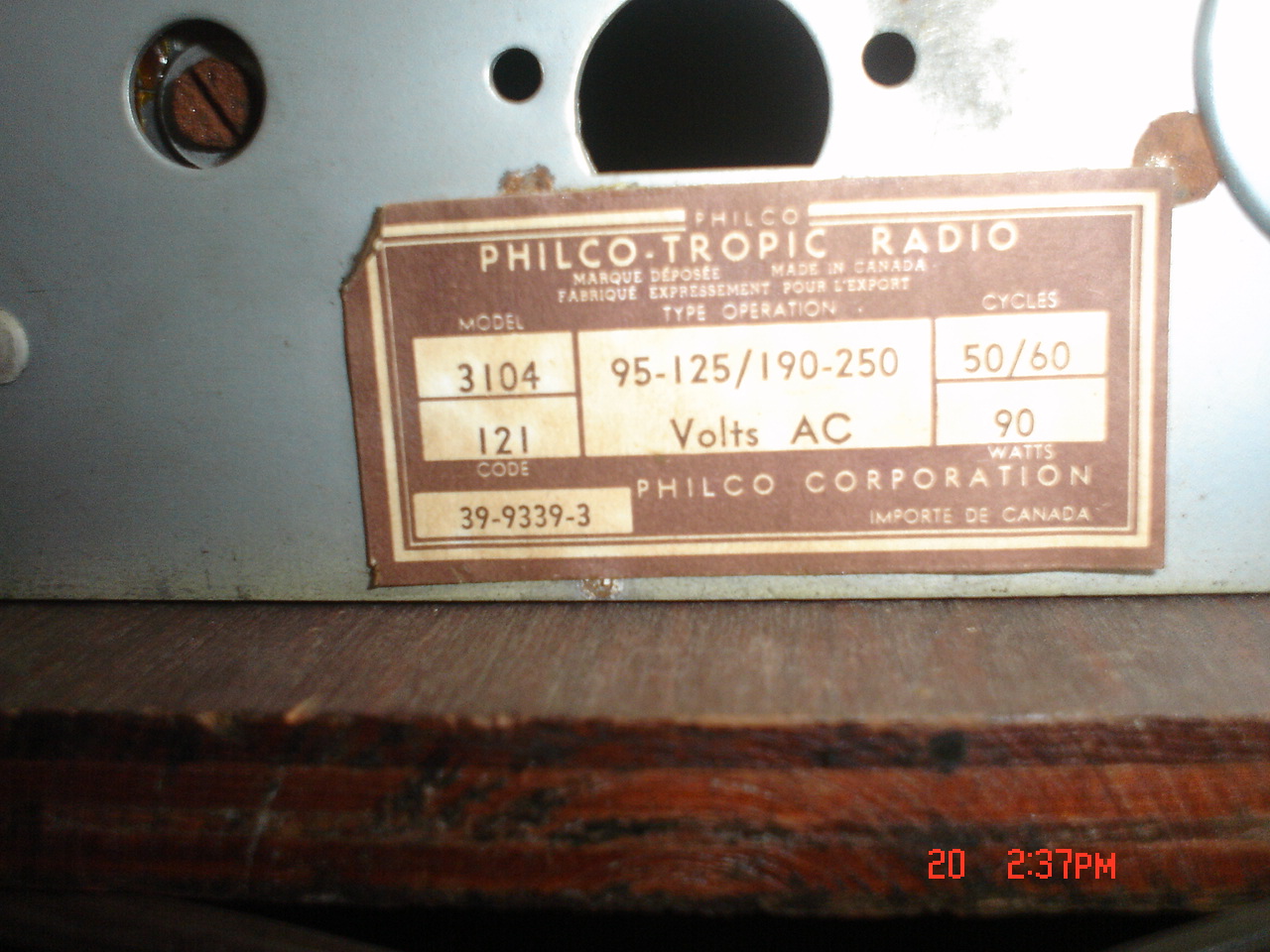

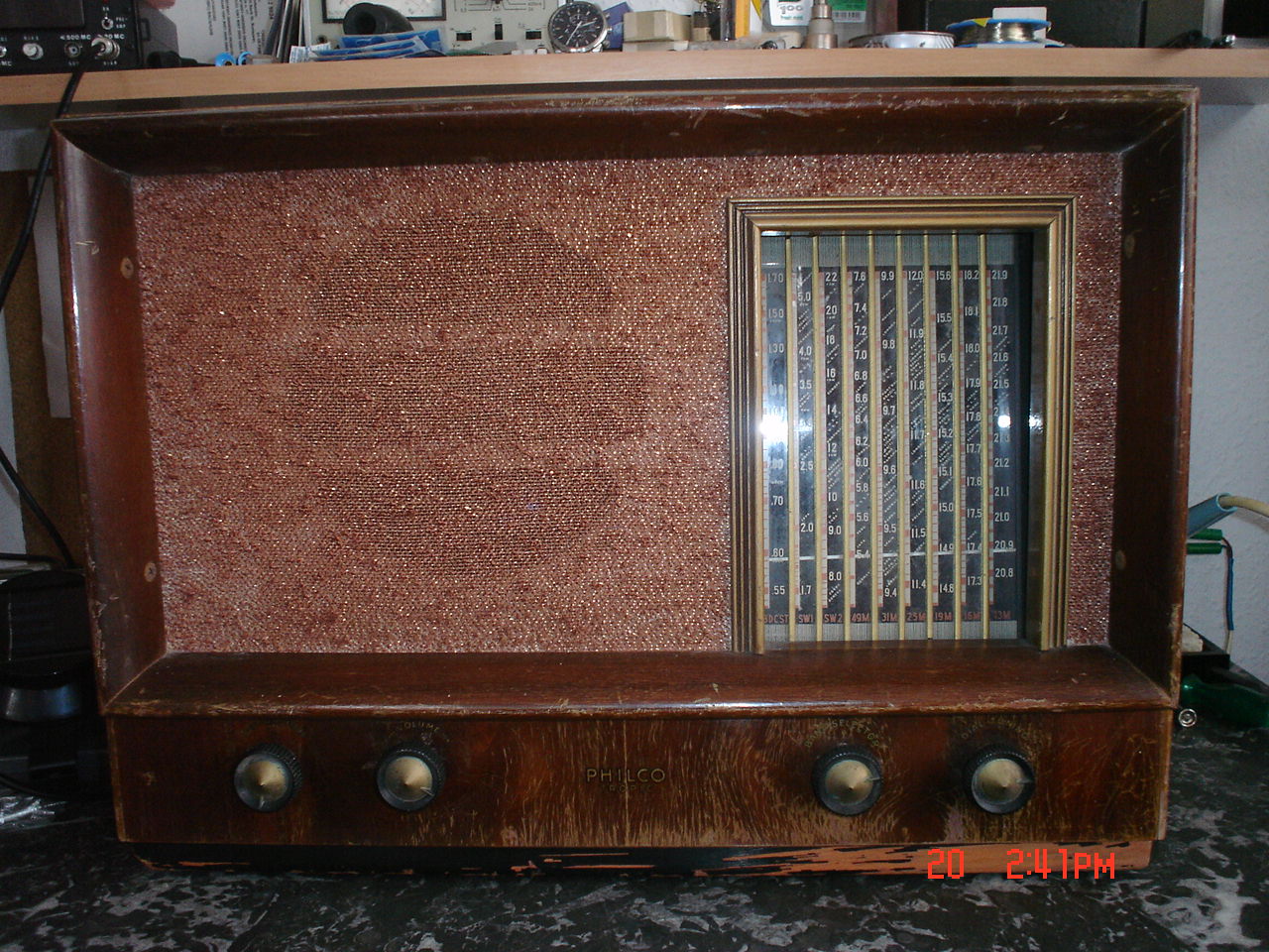

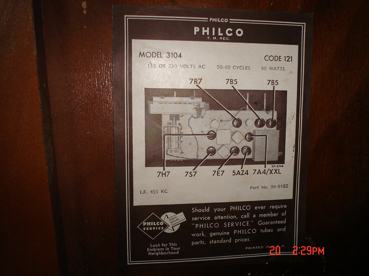

My father recently bought this Philco radio and we are having a hard time to find out more about it. The model number is 3104 and I can't find it anywhere. It's like it doesn't exist. It would be nice to find some schematic drawings.

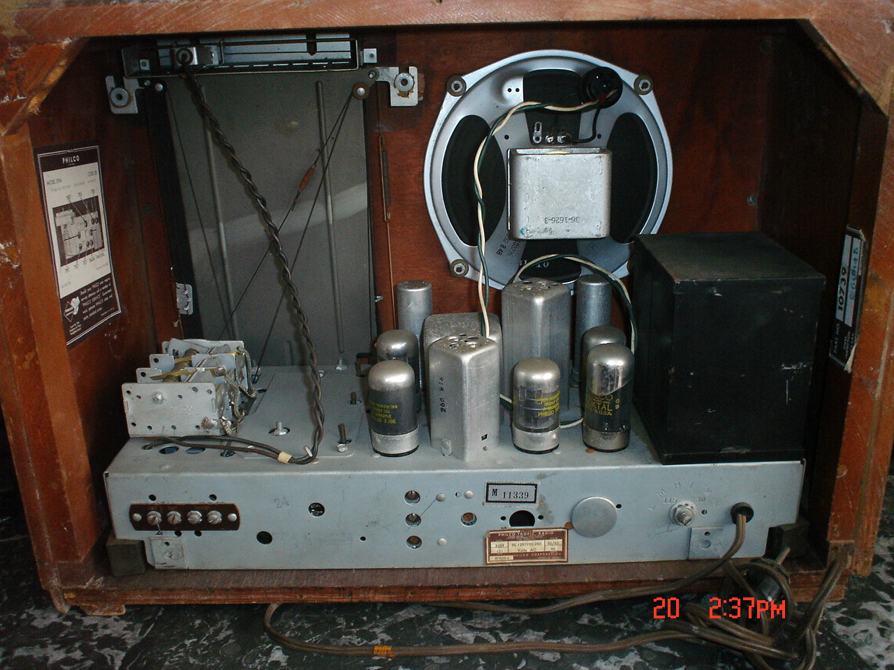

The other thing is the rectifier tube is blown. It is marked as 5AZ4. We found European equivalents for it, but those seem to have lower Amp ratings. If I could find an original tube, that would be great.

It looks like a 53-960 with a different cabinet.
I'll have to look and see if I have any other info on that model.
It looks like another version of the Philco 53-960.
Doesn't 53-960 have 5 knobs?
I think mine is the one.
yes...the center knob on the 53-960 is a radio-phono switch, I think...(at work so can't check right now)
If you need a 5AZ4, here is a seller in Canada:
http://www.ebay.com/itm/GE-5AZ4-Rectifie...SwB-1Yxu1L
If the 5AZ4 tube is blown there might be a reason for it, don't try powering it up without checking for a shorted filter cap first. The model number is probably a Philco Products of Canada model number, which is why you can't find it online, but it may be listed in the RCC manuals.

The label indicates it was made in Canada, so the next step is to see if we can find Canadian documentation for it. And if Philco Canada documented their Tropic sets like USA Philco did, well...the answer is maybe or maybe not.
