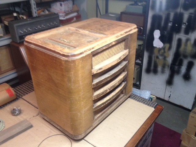

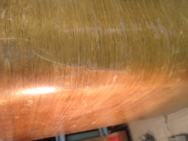

I recently was gifted a 40-170CS, I have the chassis rebuilt and working great.  The cabinet is solid but needs refinished.  The one issue I have with it though is some cracking on one of the rounded corners of the cabinet.  Much like the waterfall on the front of a console radio, the wood panel gets thinner to make the curve and is under stress.  It was stored under a desk in a shop for years and I am guess someone might have bumped that one corner a couple times.

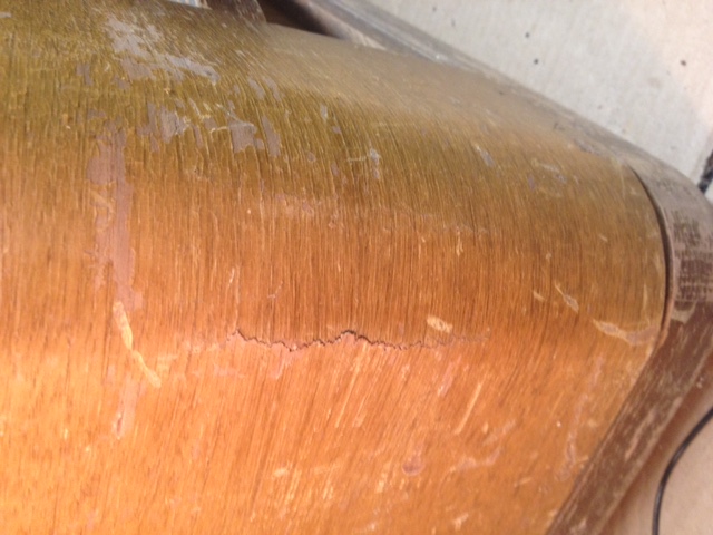

The cracks seem only to penetrate the top one or two layers of the plywood.  I am trying to figure out the best way to repair the cracks and try and get the wood back into shape.  Any ideas are appreciated!

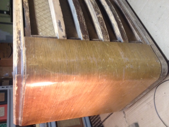

Closer look at the cracks and a couple are all the way through the wood substrate not just the veneer. So regardless of re-veneering those cracks have to be repaired-glued before refinished OR new veneer is placed over the top. I have glued similar cracks on the waterfall of a B.F. Goodrich Mantola wood table top and it has help up great the past couple years. On that Mantola I built a wooden mold to fit inside the curve and clamped-glued the crack up, worked great but was far easier to access then the cracks on this radio. That is going to be the issue.

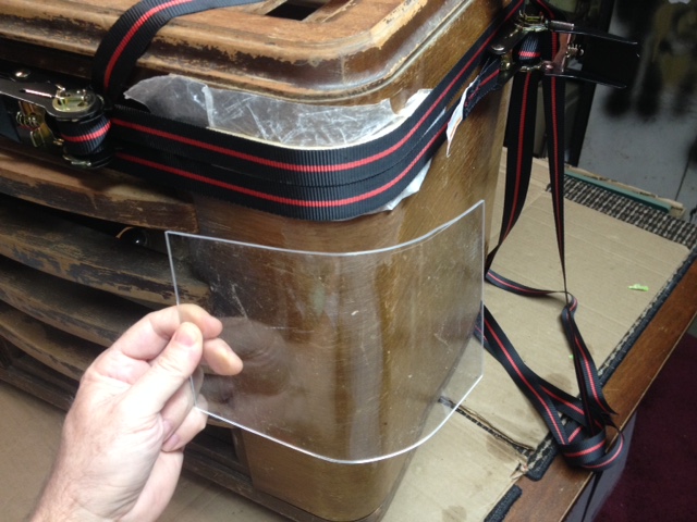

I think I am going to try molding some acrylic plexiglass to the correct curve of the corner and use it as a cull or form when reglue-clamping the crack down. Seen this done guitars with great results (see the link I posted previously).
T

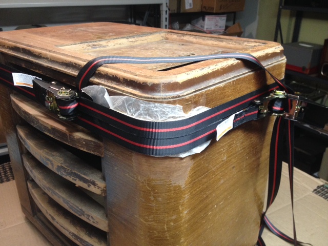

If anyone is interested here is some updates.
I tried the plexiglass trick used on guitars.  It was a failure for this type or crack.  I could see it 'possibly' working on another type crack but this crack no go.  Issues were the plexi was difficult to heat evenly enough with a gun to flex and mold to the piece with precision.  Once I got it REALLY close I found the next problem is the plexi was too stiff.  For this crack on the curve you need something to compress it back into position.  That wasn't possible with the plexi.

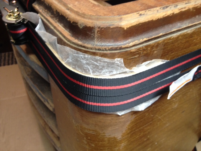

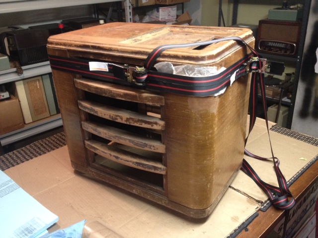

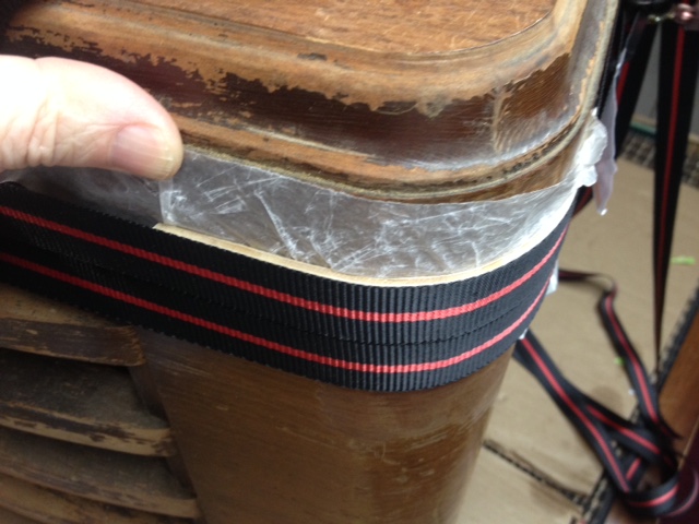

What I found seemed to work (so far it isn't dry yet) is the strap clamps.  I removed all finish from around the crack and dampened the area so it would flex and draw the glue in better.  Then brushed some 50/50 glue and water mix into the crack.  Compressed it and pushed it around.  The glue REALLY got in there good even where the crack was not opened but visible.
I then used a sheet of wax paper and a small piece of 1/8 plywood dampened so it would flex and follow the contour of the cabinet easily over top of the crack.  Then two strap clamps (basically ratchet tie downs) around the cabinet and over the plywood.  I cranked em down good and I it seemed to compress that crack and damage back into a perfect curve.  This strap clamp worked amazingly well for the bottom frame so thought try it here as well.  Will update how it looks tomorrow after it dries.

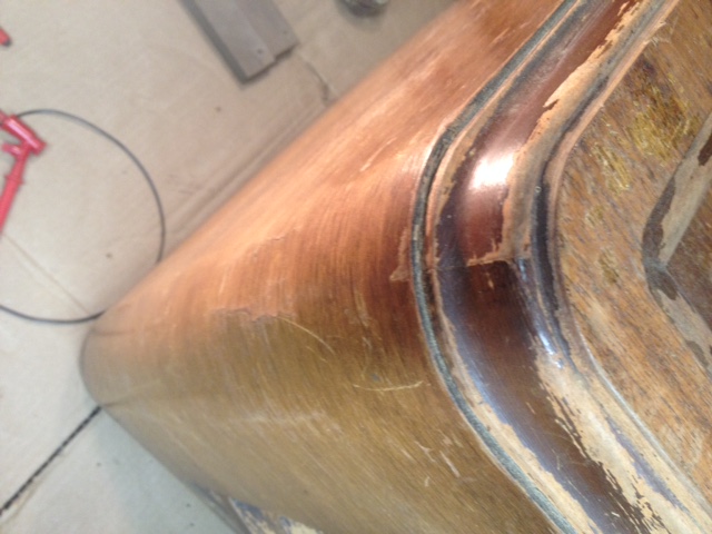

Here is the cracks repaired and cabinet refinished.  It turned out well and saved having to re-veneer the entire cabinet.  If I point it out you can still see the 'scar' of the original crack but it is fixed-solid and practically invisible.  Very happy with the out come.
